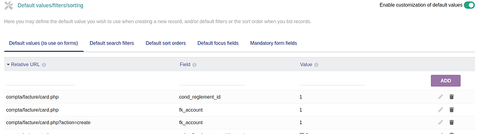

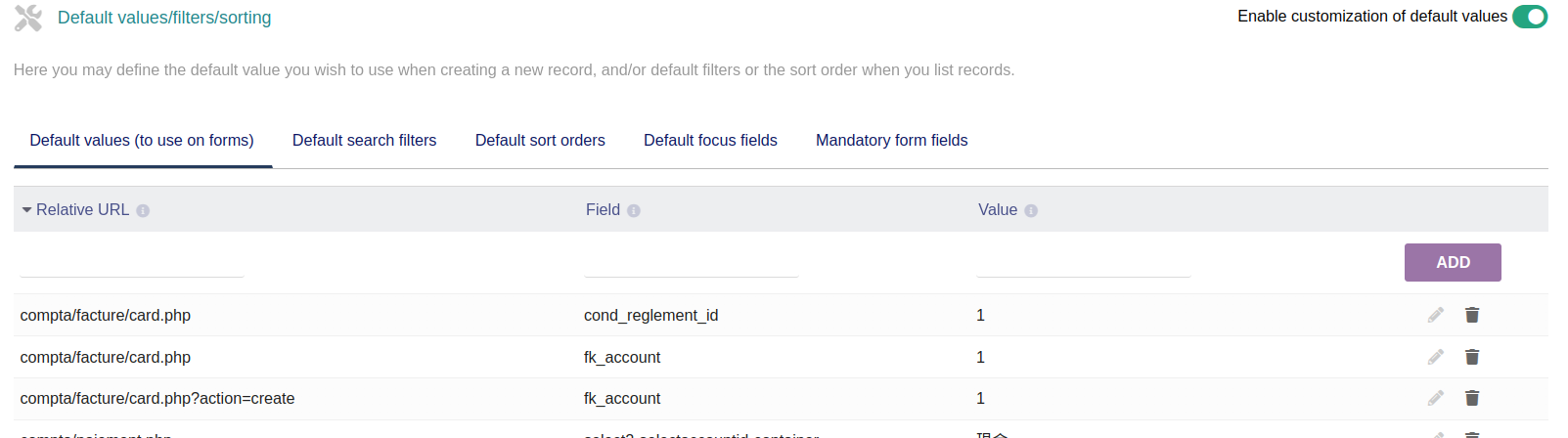

Hi
I think it doesn’t work for Bank account ( id = fk_account) in dolibarr 19.0.4 .
it works for me, with id1 i have EC-Card, can you explain why it is not working for you, what do you get with your configuration?

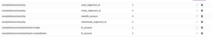

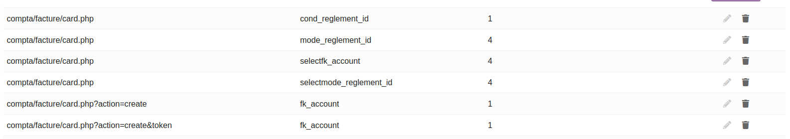

Hi
Below is my configuration .
And if you create a invoice directly , then bank account will show id1 .
But if you create a invoice from an order , then it doesn’t work .
It will show blank .

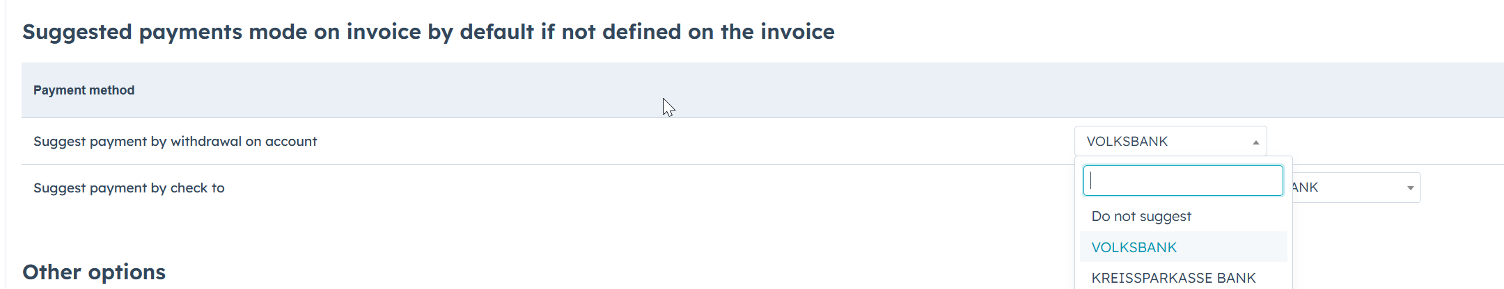

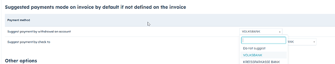

If it’s blank then it’s because the order has a blank field for bank account. Invoice just copies whatever is in the order.
the bank account is taken from the proposal but if the field there is empty. You can set a default in the invoice modul.
