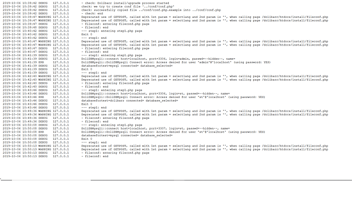

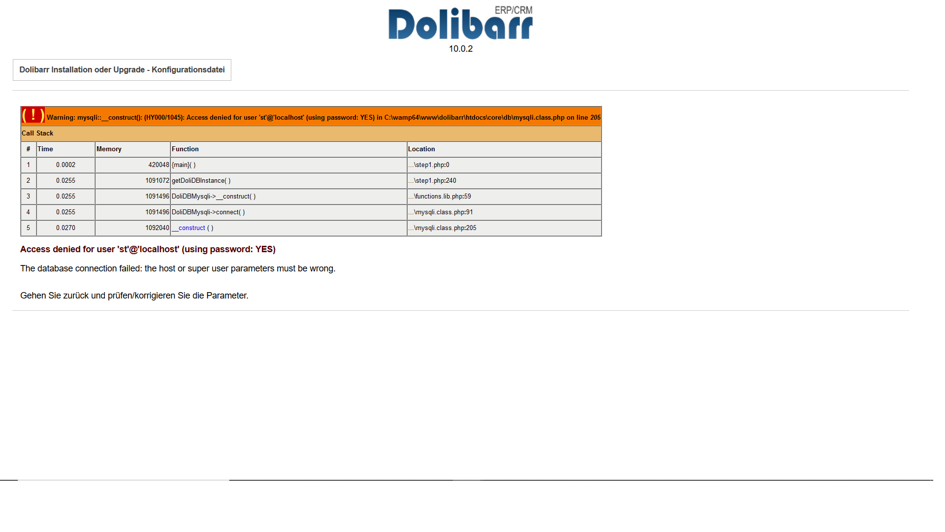

Okay, thanks. I tried my luck already again… now I´m stopped here. Any Idea?
The connexion to the database is not possible.
Check login/password of the database

I tried to create a new database ‘dolibarr’ and restored the backup file. But not updating the dolibarr. Seems like the mysql ports are different (3306 is wamp and 3308 is dolibarr installed)

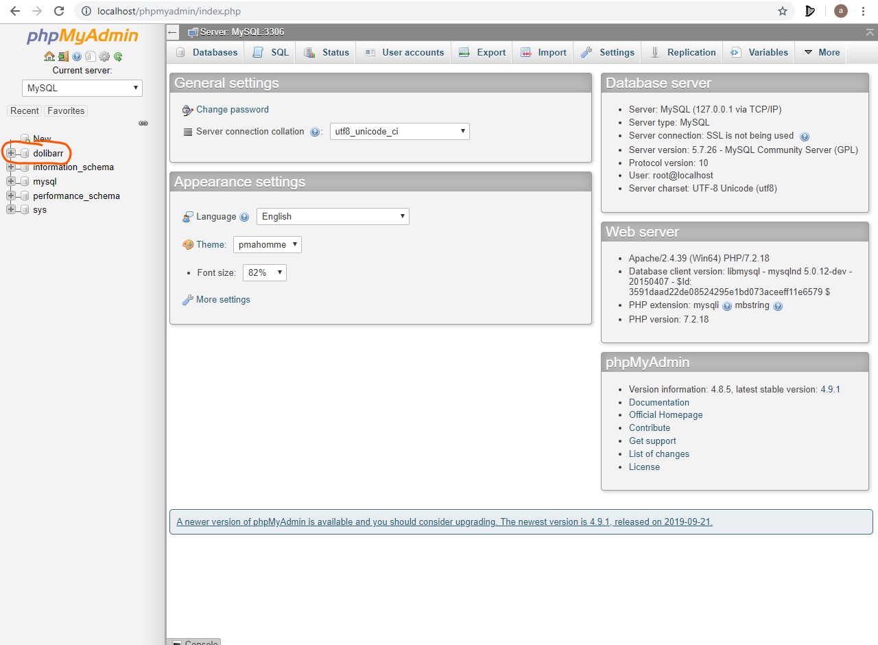

please check if the choosen port is open and not used by any other application. In phpmyadmin please click on database folder dolibarr before you import the old database.
