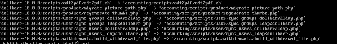

But somehow I’m missing something, and the update routine doesn’t start automatically. Here’s what I did:
  1. Downloaded latest files from Sourceforge
  2. Followed these instructions
  3. I’m positive that files were copied into the correct folder (“accounting”), here’s a screenshot:
But when I log in, it still just shows version 9.0.2, and no update/install routine starts.
I read the README.md instructions, but to no avail. Also, I noticed there’s the INSTALL text file, but there’s no “install” folder.
Thanks for any suggestions!
I figured it out, just sharing in case somebody else is interested.
The original instructions indicate that all files from the unzipped Dolibarr 10 file should be copied:
$ cp -r dolibarr-x.y.z/* dolibarr
However, it’s actually only the content of subfolder “htdocs” that should be copied over into the existing Dolibarr folder (the current installation).
So the correct command is this (assuming that Dolibarr was installed in the subfolder “dolibarr”):
$ cp -r dolibarr-10.0.0/htdocs/* dolibarr
I just did this and updating took just like a minute or two.
