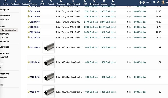

I currently have some products that are not showing in BoM or quotes that should be.
The two image below show some products. The tube, is for sale, and for purchase.

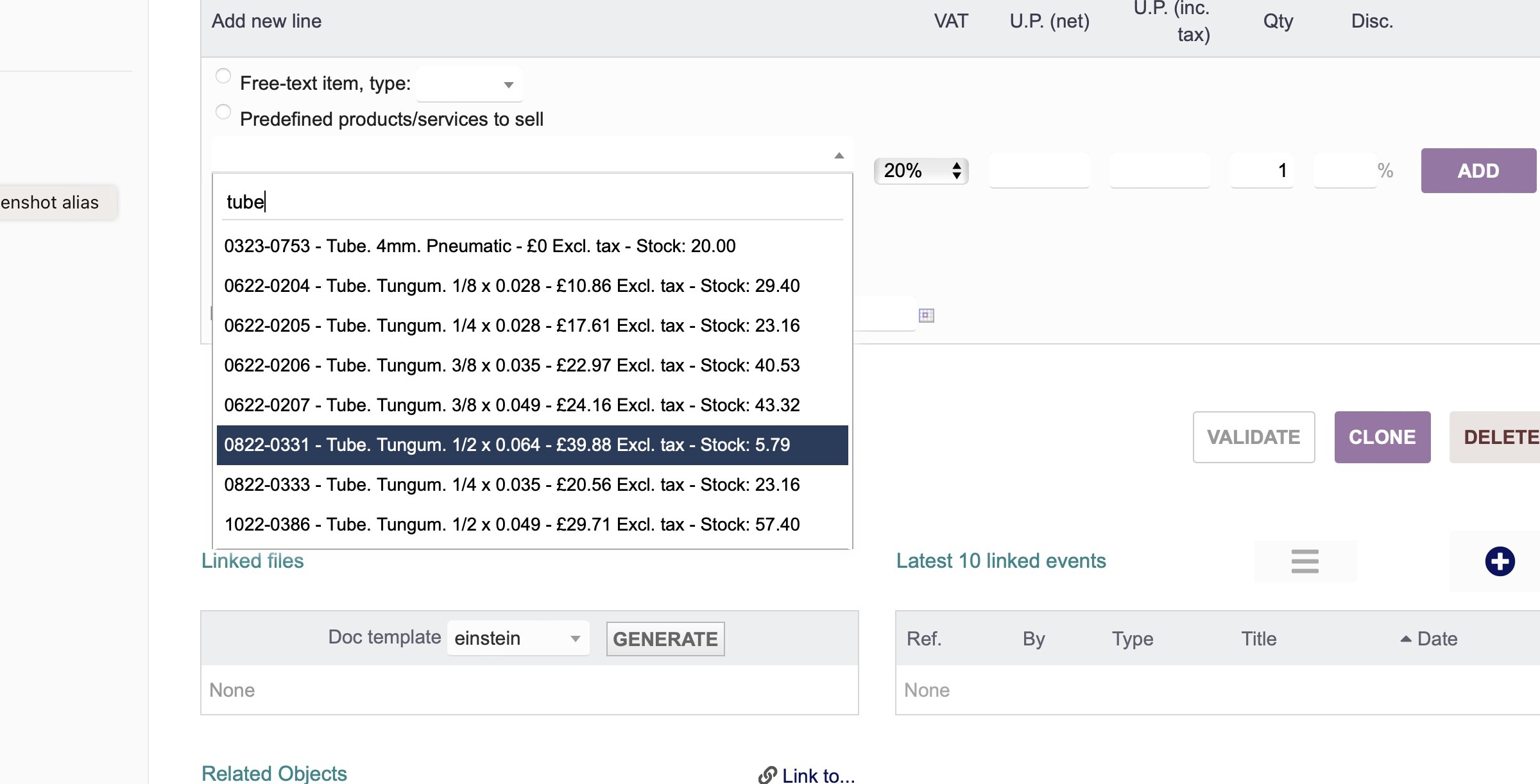

The second screen shot, show theStainless tube not in the list
available for adding a sales order, or BOM.
Can anyone help diagnose this.
V19.02 php 8.0
How many products are in your database? Did you check and possibly adjust your settings as described above?
Many thanks.
Apologies, it had been a long day, you were quite correct.
(I couldn’t see the forrest for the trees ![]()
