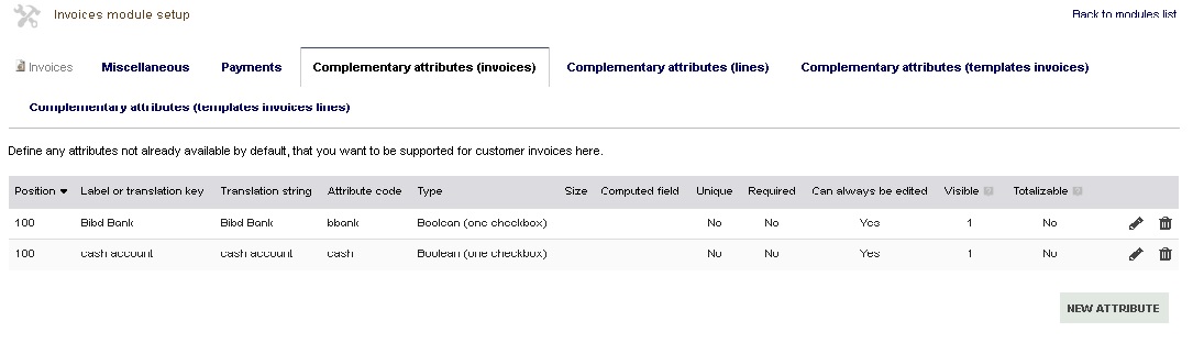

This is what I did and solve on testing environment… need to test on production environment.
I created 2 complimentary fields in Invoice -
and then in odt template i added this -
[!-- IF {object_options_bbank} --]
Bank - 1
[!-- ELSE {object_options_bbank} --]
[!-- IF {object_options_cash} --]
Cash
[!-- ELSE {object_options_cash} --]
Credit Card
[!-- ENDIF {object_options_cash} --]
[!-- ENDIF {object_options_bbank} --]
