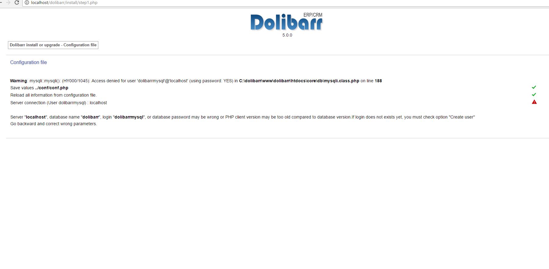

I’m trying to install de beta version on my windows 10 computer, with Doliwamp-5.0.0-rc1.exe
It’s show this error:
"Warning: mysqli::mysqli(): (HY000/1045): Access denied for user ‘dolibarrmysql’@‘localhost’ (using password: YES) in C:\dolibarr\www\dolibarr\htdocs\core\db\mysqli.class.php on line 188

I also am just trying Dolibarr and am getting the following error:
Save values …/conf/conf.php Ok
Reload all information from configuration file. Ok
Server connection (User dolibarrmysql) : localhost Error
Server “localhost”, database name “dolibarr”, login “dolibarrmysql”, or database password may be wrong or PHP client version may be too old compared to database version.If login does not exists yet, you must check option “Create user”
Go backward and correct wrong parameters.
