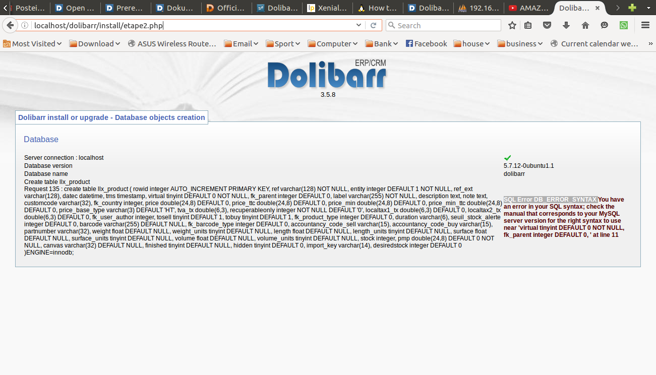

I am trying to install Dolibarr on UBUNTU 16.04. And run in many problems.
1st I tried that way: How to install dolibarr on Ubuntu
Version 3.5.8+dfsg1-1ubuntu1
but during Installation I run in the following error: www.dolibarr.org/t/sql-db-error-syntax/13295/1 (which is not solved yet here in the forum).
Okay - but the hint is clear: a higher version can , maybe , make it :smiley:
