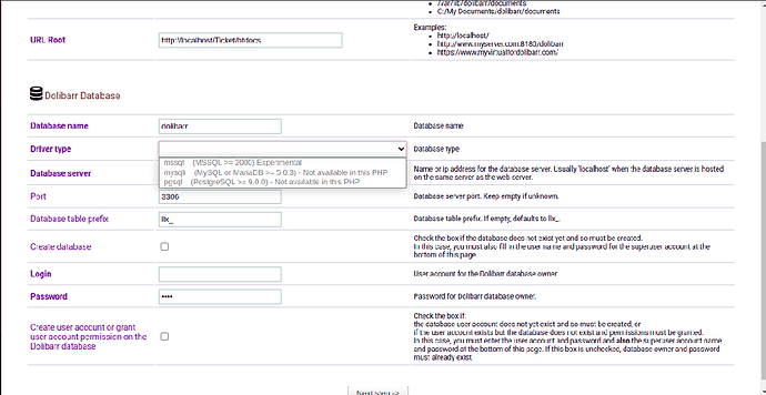

Hello friends, I hope you are doing well.
Please if anyone can help me to solve this installation problem otherwise in ‘database type’ I have no choice for Driver database type as you see on this image.
normally the database server is localhost.
did you install mariaDB?
I suggest to use a front end for the maria/mysql managing as phpmyadmin.
It must be installed at the server.
I also recommend to install webmin.
Then, with one of them create an empty database called dolibarr.
At the installer don’t tic “create” Just type the mariadb/mysql credentials and let the intaller create tables and etc.
As said in the combo, the driver for mysql is not installed in your php.
You must install php package like php-mysql or php-mysqlnt
