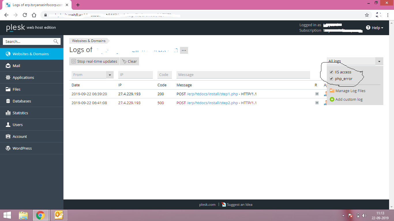

We need the apache log to understand : https://www.hostgator.com/help/article/can-i-access-my-apache-log-files

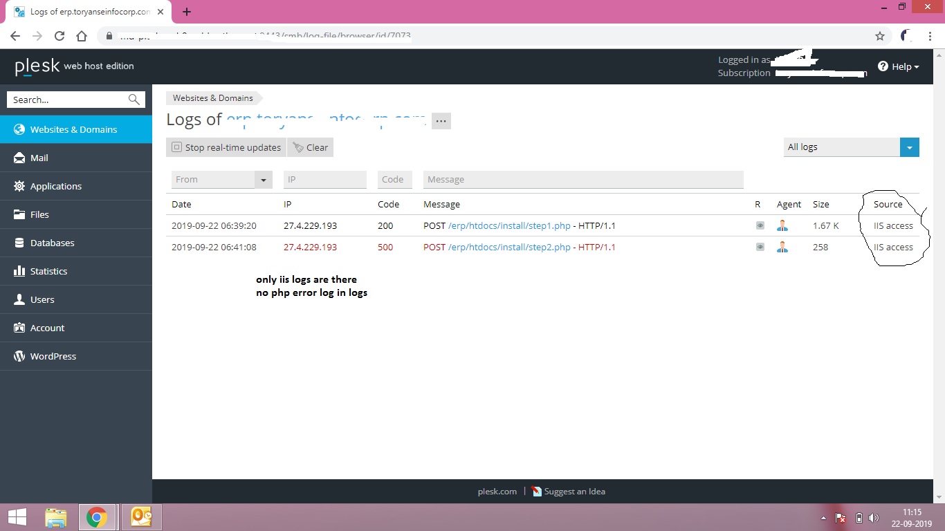

we do not have option for apache log in plesk panel.
we have option logs and in that iis acess logs and php error logs.
i didnt get any php error log in my logs.
DO you have details on the error ot the 22-09-2019 06:41:08 ?
i dont have any error at that time…
i dont get any error in my log…
No error in log
In browser it shows
The page cannot be displayed because an internal server error has occurred.
Then you need to ask hosting compagny how is it possible that a error 500 doesn’t generate a log

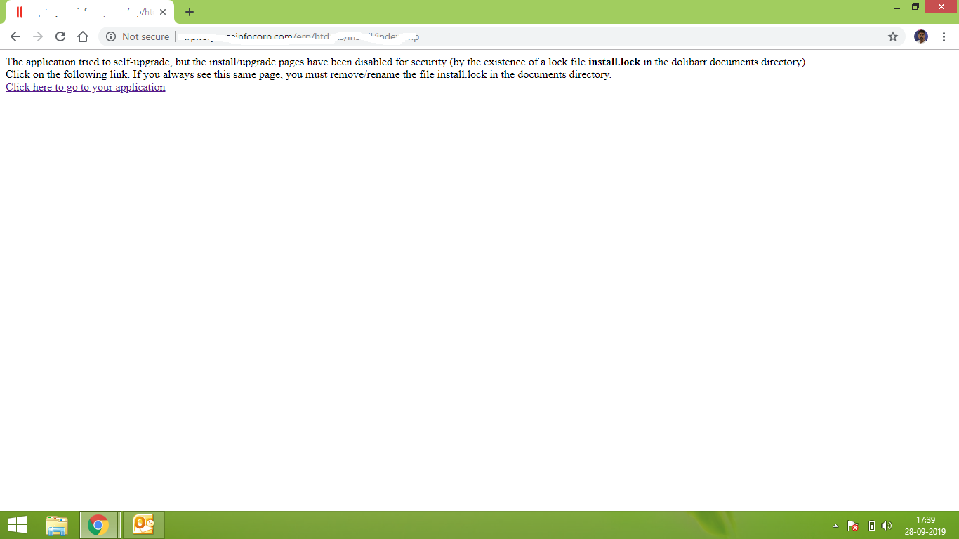

now when i go to htdocs in the browser, it shows me installation page again.

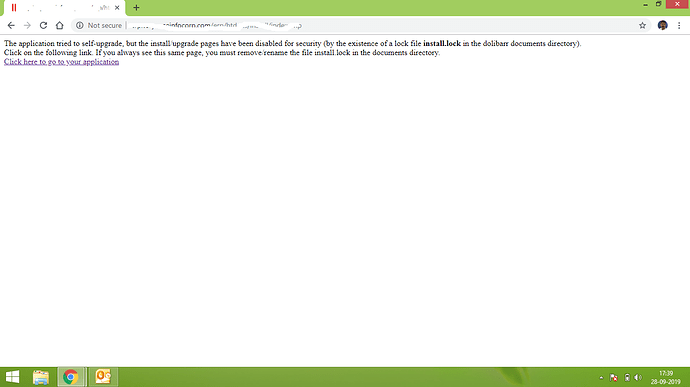

i have added install.lock. still it shows installation page
after adding install.lock in document folder
i get following image
when i click on “Click here to go to your application”
it comes to same page again
check conf file. also check version in database and files version.
