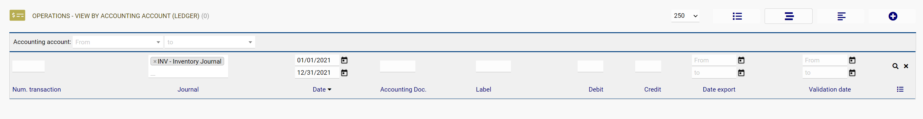

I am not seeing any inventory transaction in the INV (Inventory) Journal when I try to run the report, and unlike the other journals am I missing something as I can see movements at the item level but need to be able to get to this information? I am utilizing the Double Entry Accounting Module and Manufacturing orders, so I have to be able to audit these transactions. I also believe I have an issue with items not posting to the ledger correctly so need to get this resolved quickly
Appreciate any help you can offer

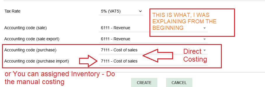

I am sorry but I do not understand what you are stating, are you stating I set-up something wrong or that Dolibarr has not programmed this and the function does not exist?

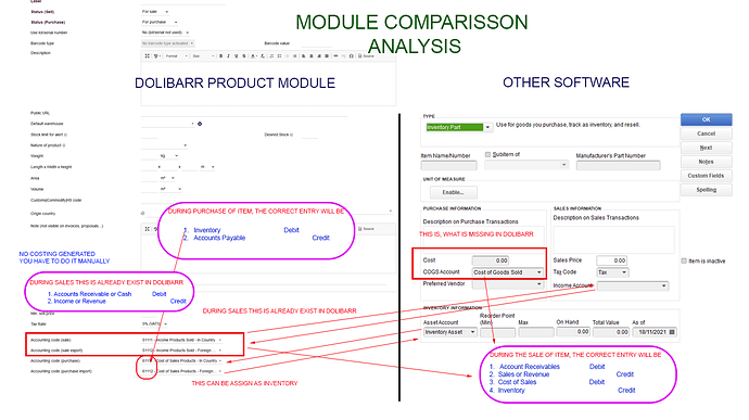

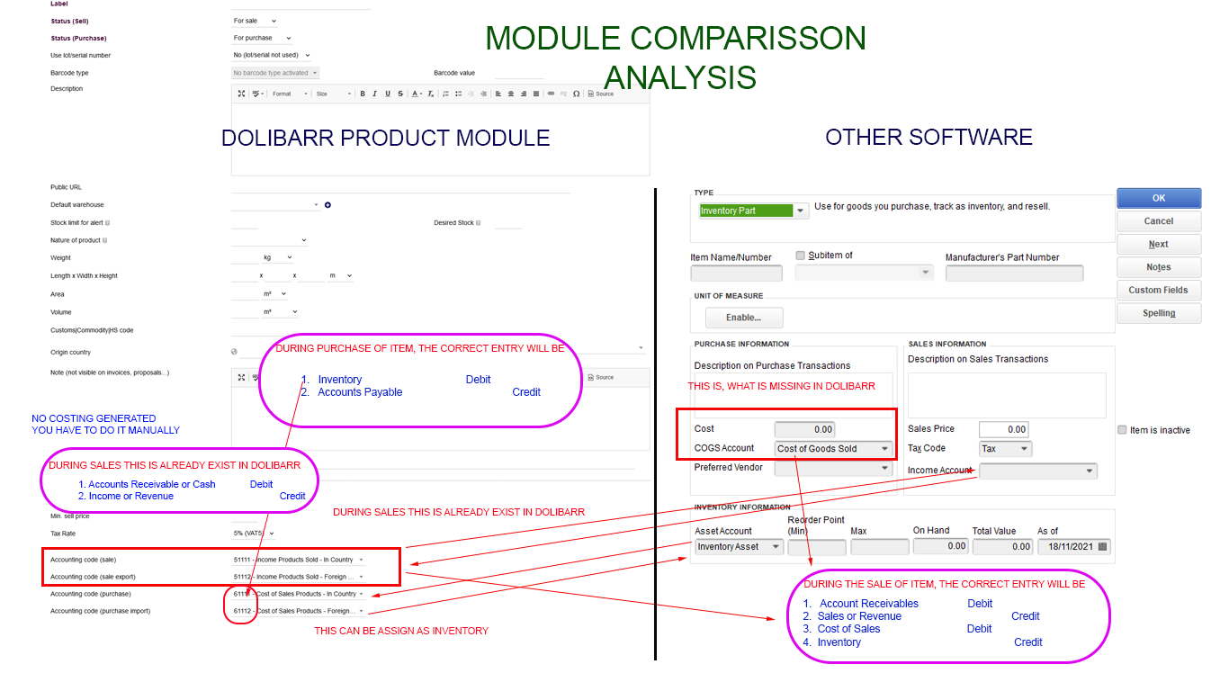

I am talking about what is missing when you setup the Item:
This picture below is comparisson and journalization effects,
Can you explain how? Or As for me I did the Costing manually, Oh dolibarr is Free Anyway.
By the Way Straight 3 year with 4 Accounting Cycle I used Dolibarr. Audited 4 times.
Okay, I am running Windows Server, 120gm solid state, 30gb ram, Dolibarr version 12 upgrade to 14, PHP 8 mysql 8.0.17. It is running fine. Everything is okay. Now I want only to know how to do that Inventory and Costing
I am saying, Nothing so called Inventory Module, It is called in Dolibarr Products Module. You have to understand that.

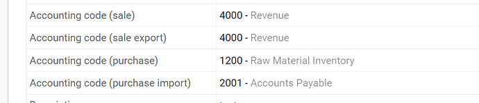

I am sorry but I am still confused by what you are stating, I set-up a test item received in items and corrected stock but I still see nothing in the inventory journal. Below is how I set it up, based on what I think you were stating in your previous.
You have a wrong setup,:
Your entry for purchases import will be resulted to this:
2001 - Accounts Payable - Debit
2001 - Accounts Payable - Credit
The Correct shall be(let say you assigned Accounting code (purchase import) 1201 Materials Inventory
1201 - Materials Inventory - Debit
2001 - Accounts Pyable - Credit

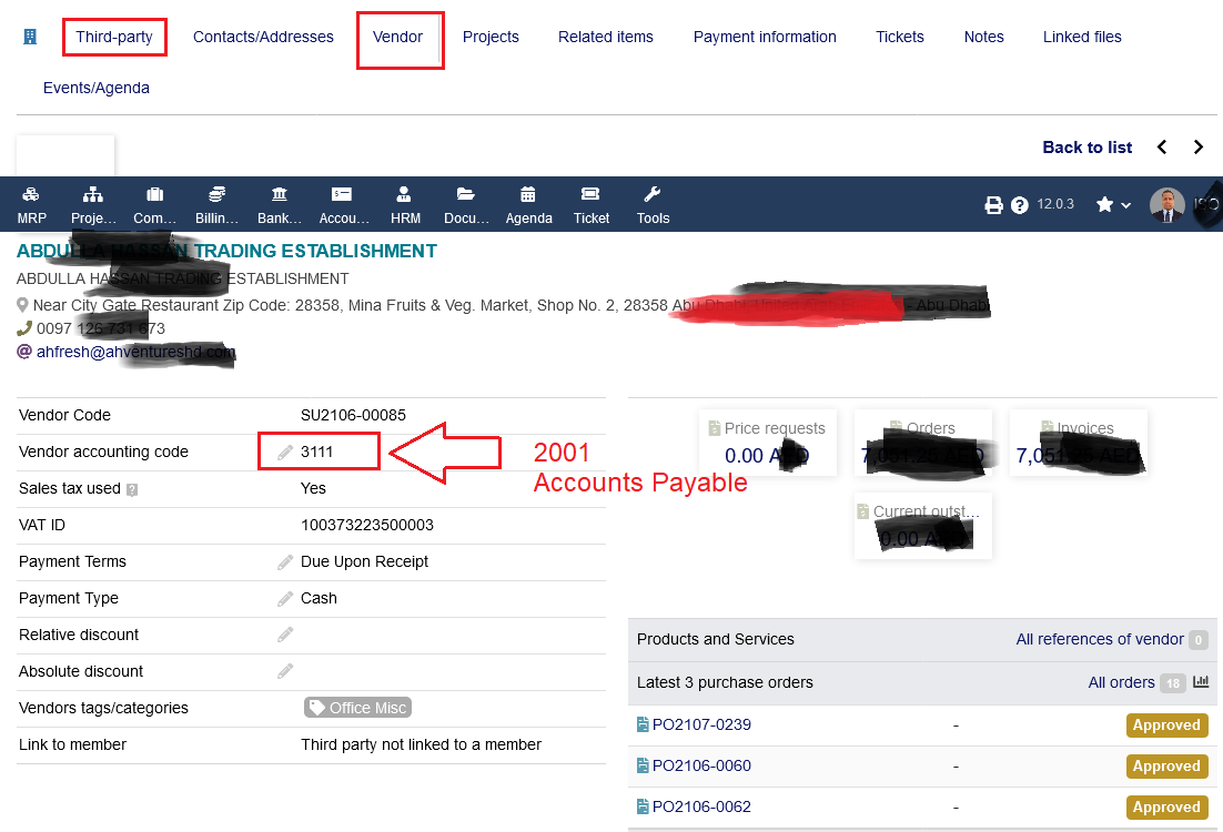

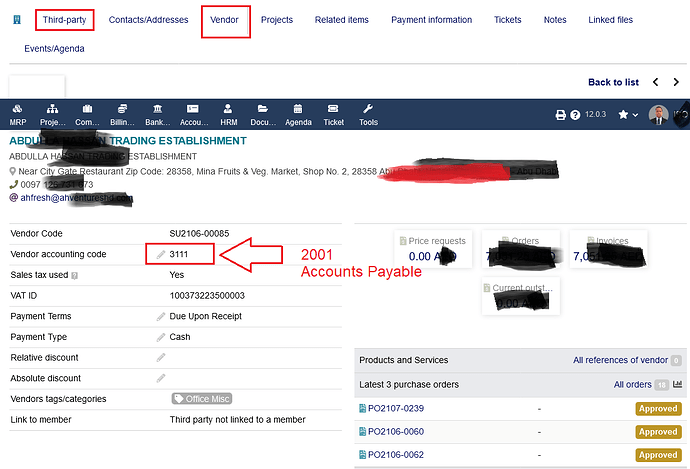

That Accounting Code should not be there because you are setting up the Products or Services.
The Accounts Payable which is you assigned 2001 should only be assigned on the following Module:
Third party —> then Vendor Setup then that 2001 Account code shall be there, below is the picture
On your case, You need to assigned either, Cost or Inventory Account meaning either Assets or Cost/Expenses, it is wrong to assigned Liability Account for setting up New Products.
Yes you are right, the stock is correct and the corresponding amount but your Journal Entries will be resulted into wrong Accounting Code(on this case Liability vs Liability).

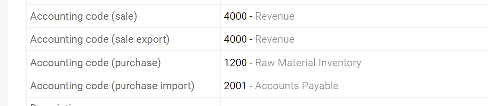

I am sorry to bother you again, but I am setting up items that are issued to manufacturing orders I assume Account Code (sale) should have the items issued to Inventory Work in Process (WIP) but do not understand the reasoning for 4 accounts or should they just be the same as the one above?
|Accounting code (sale)|1210 - WIP Inventory|
|Accounting code (sale export)|1210 - WIP Inventory| **** This One*****
|Accounting code (purchase)|1205 - Product Packaging|
|Accounting code (purchase import)|1205 - Product Packaging| **** This One ****

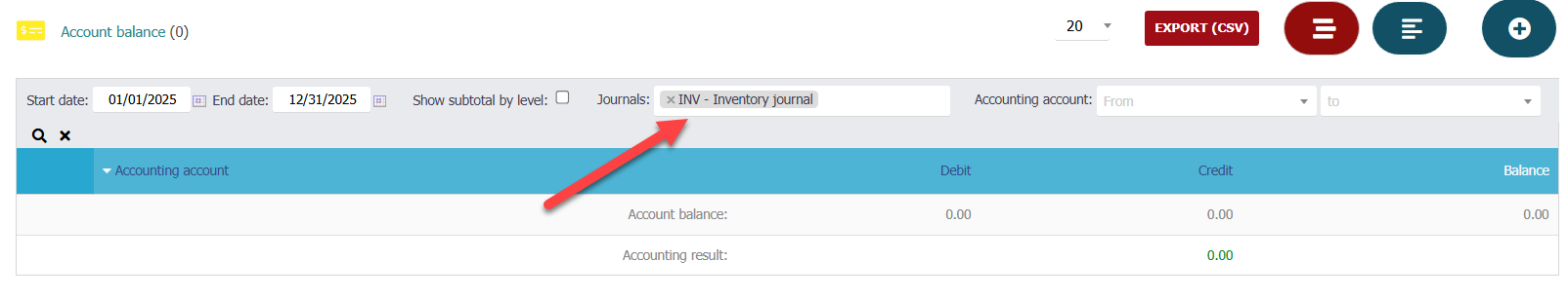

Dears,

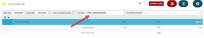

if you please can you clarify how to read inventory journals in the reports of Accounting
I made all your clarifications but can’t read any thing in (inventory journal) for example

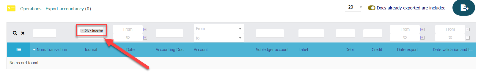

also,
or you advice to buy the module
