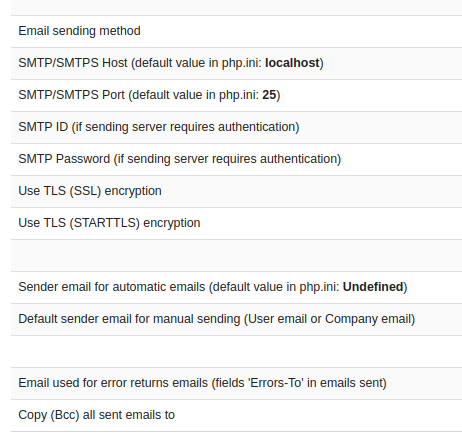

Is there any way to send an Invoice as a BCC(Blind Carbon Copy) email to several participants?
I know there is a way to define a BCC email, but the problem is, it will send all emails to the BCC email address.
Screenshot from 2020-08-13 11-11-45
Any Help would be much appreciated.

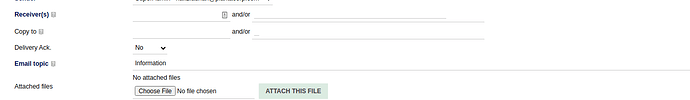

I was reviewing the Dolibarr Guide today because I know you can BCC emails sent from Dolibarr, but I was not seeing the BCC field either.
The Dolibarr Guide says:
MAIN_EMAIL_USECCC => 1 = Display the BCC field in email forms, If email = Show BCC pre-filled with
email.
I queried the llc_const table to make sure that the constant was not already defined.
SELECT * FROM `llx_const` where name like 'MAIN_EMAIL_USECCC'

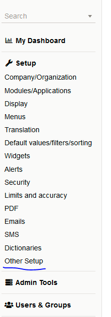

It was not. So in the Dolibarr interface, I visited Home>Setup>Other Setup
Under “Other Setup”, I added MAIN_EMAIL_USECCC and set it to 1.

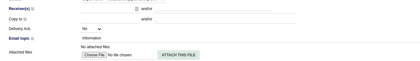

Now when I send an invoice email, or any email for that fact, there is a new field for me to set the BCC.
Let me know if this helps or if you have any questions.
