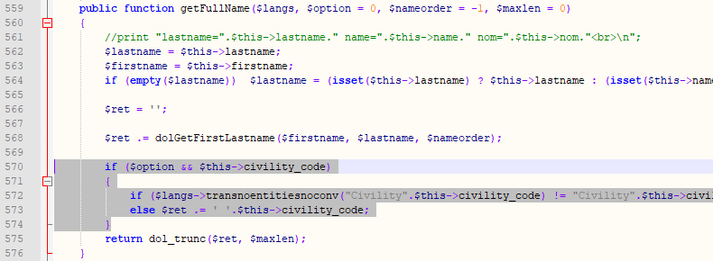

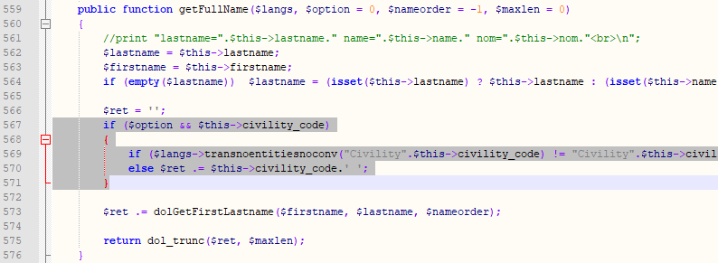

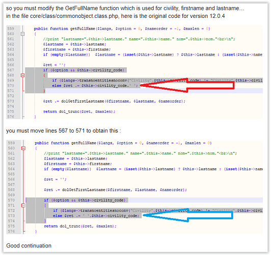

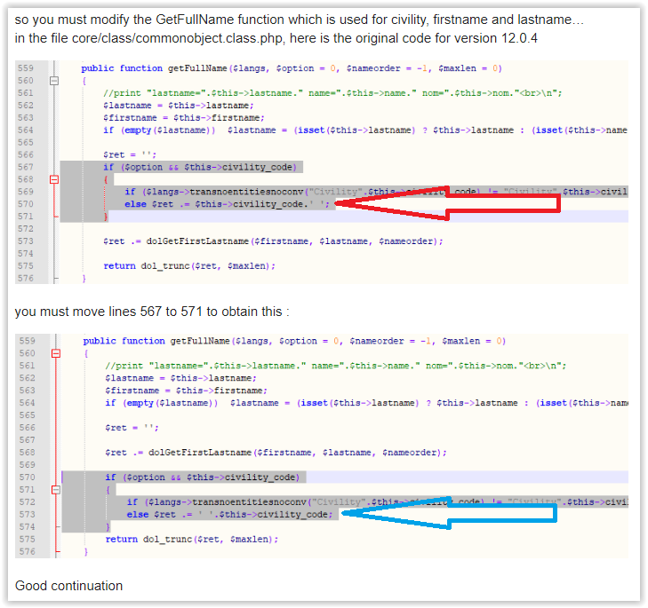

so you must modify the GetFullName function which is used for civility, firstname and lastname…
in the file core/class/commonobject.class.php, here is the original code for version 12.0.4
That works , thanks a lot .

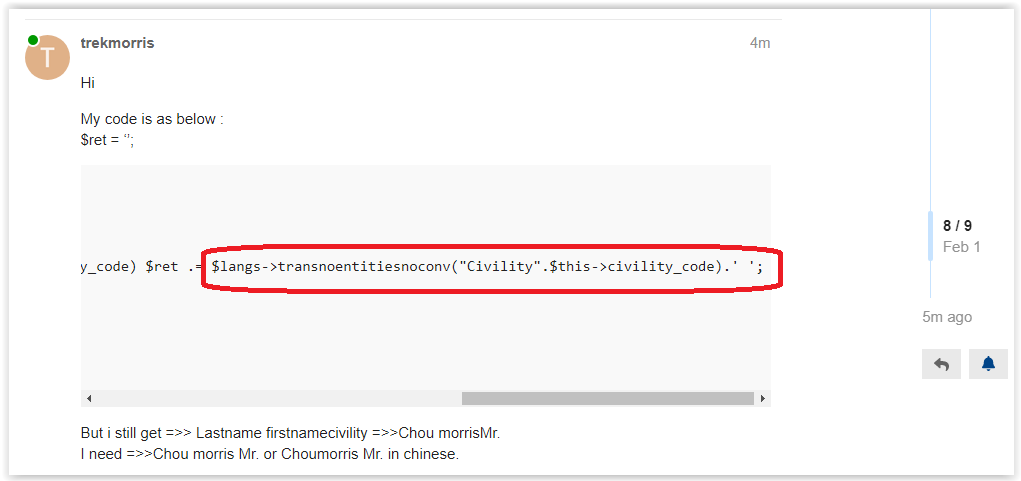

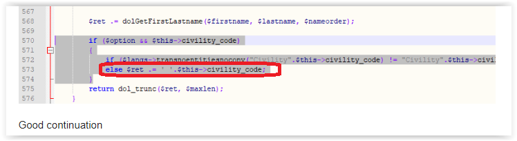

I have the other question is if i want a space ( blank ) between first name and title how do i do ?
Like Chen Andy Mr. not Chen AndyMr. .
