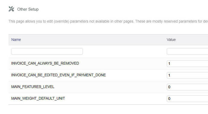

It seems that none of the Settings in "Other Setup" have taken effect. What's the problem?
It seems that none of the Settings in “Other Setup” have taken effect. What’s the problem?
would be good to let know which version of Dolibarr you are using.

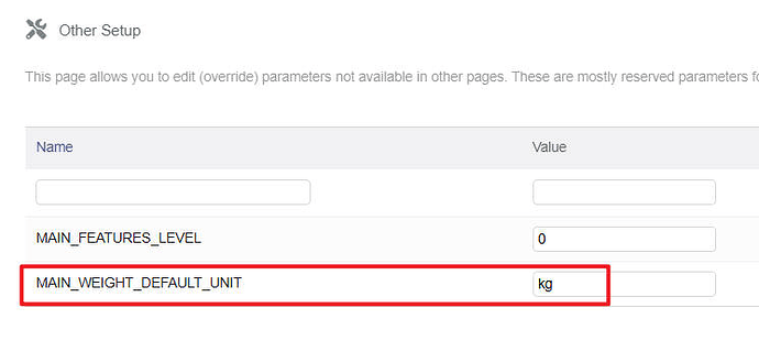

MAIN_WEIGHT_DEFAULT_UNIT needs the Unit in the Value field:
MAIN_FEATURES_LEVEL 0 shows the standard level of features - what do you expect?
if you would change to 1 or 2 you would see some more modules which are currently not stable:
1=stable+experimental, 2=stable+experimental+development
I’m using version 23.0.1

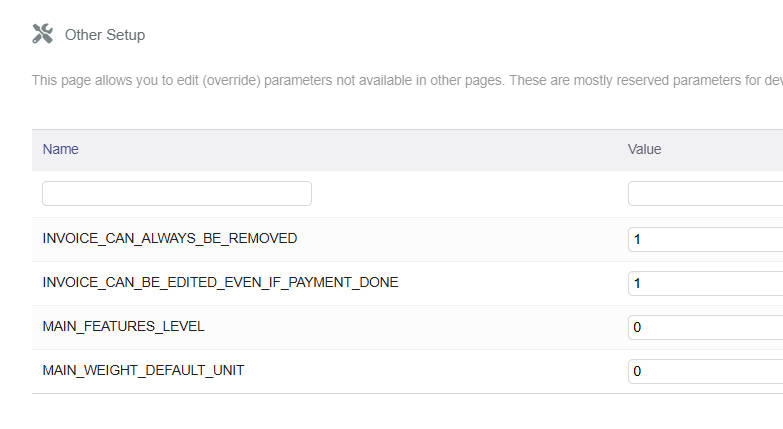

I need to change “kg” to the default unit of weight
I’ll take “MAIN”_WEIGHT_DEFAULT_When UNIT is changed to 0, 1, 2, -1 or -2, there is no change at all. It still shows mg

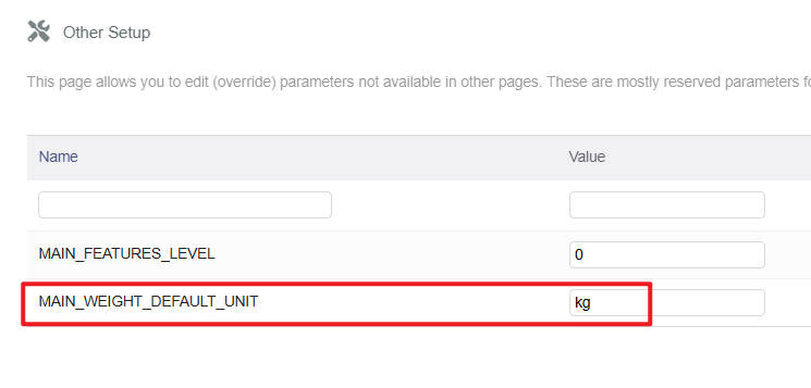

please sent a screenshot of your setup. it needs to look like:
with this settings all new products will have kg as dafault unit.
