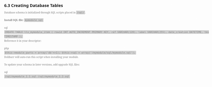

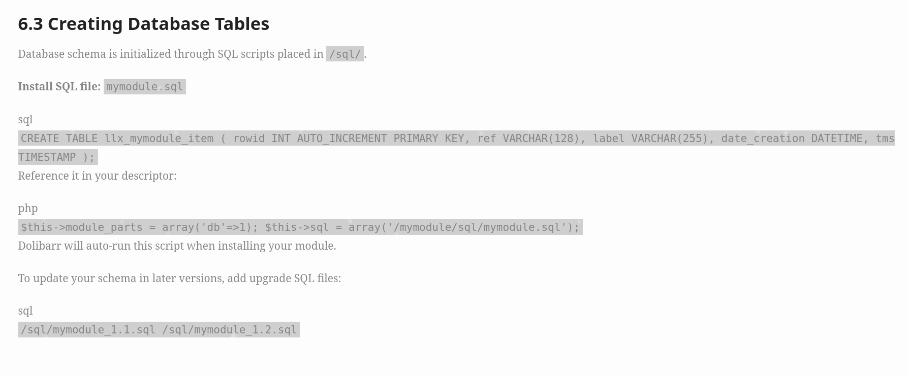

Does anyone know of an open source module that creates and manages its own table in a way that’s non-intrusive? I have created an llx_ksef_submissions.sql according to the idea from Building Your Own Dolibarr Modules: A Developer’s Guide | Dolibarr MarketPlace
But I guess I should be careful to make it in such a way that it can be upgraded without breaking things in the future, since it could end up adding extra slop into this table if it’s run multiple times with different fields in it in future versions, correct? My SQL skills are pretty low-tier
If there is,a unique key in table, you don have to manage anything. It will guarantee there is no duplicate.

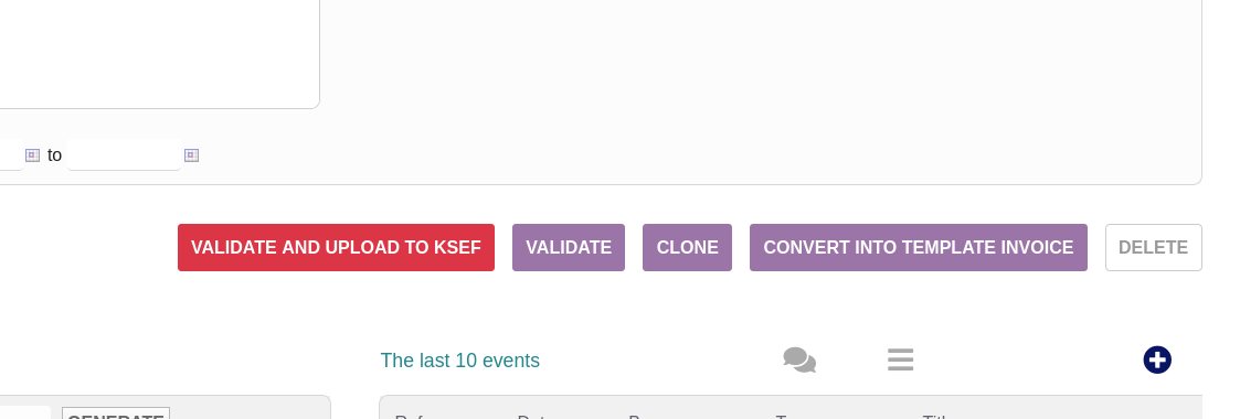

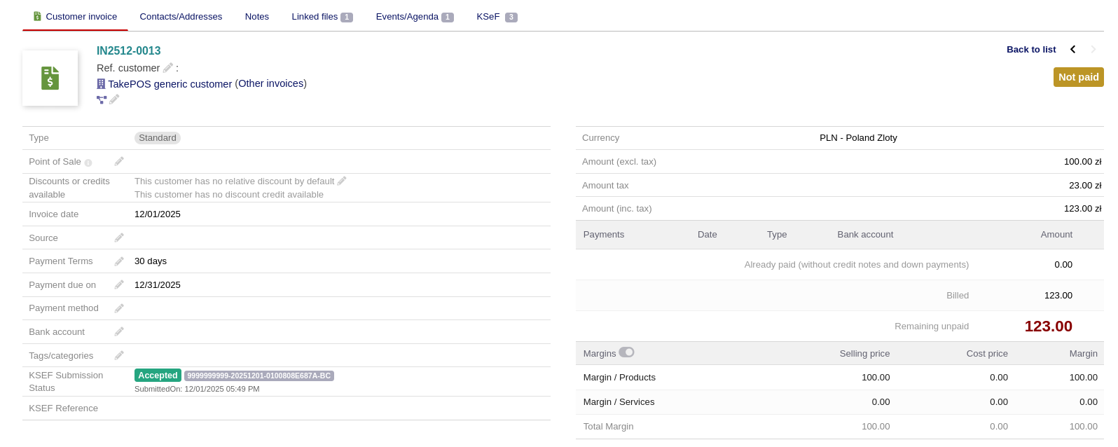

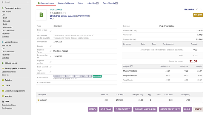

Just to give some update, I’ve got invoice submissions working! It’s a somewhat “minimal” working example - so it doesn’t handle corrective invoices and very likely some edge cases yet, but I am excited to share some screenshots anyways.
On the invoice page, next to “Validate Invoice” button, there is a Validate and Upload to KSEF button. If the invoice is validated “normally” with the Validate button, then instead a “Upload to KSEF” button appears instead. In the event the Third Party is added to the “exclude from KSEF” list in module settings, then these buttons will never appear (although in this example I’m using the Generic TakePOS customer for testing, in general I understand KSeF is not required to submit for B2C transactions)

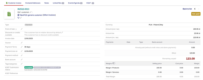

Once it’s been uploaded via either method, the KSEF number is displayed along with the extrafields, is clickable to open the online verification portal, and displays relevant information.

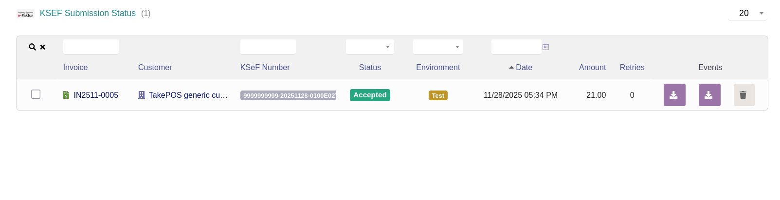

Finally, the Submission Status page in the lower left on the sidebar opens a page where all submissions to KSEF can be seen. Environment and retries are temporary columns just for development for now, and the two download buttons allow you to look at the FA(3) invoice you sent and the UPO confirmation respectively (but I will have to figure out which icons work better later on)

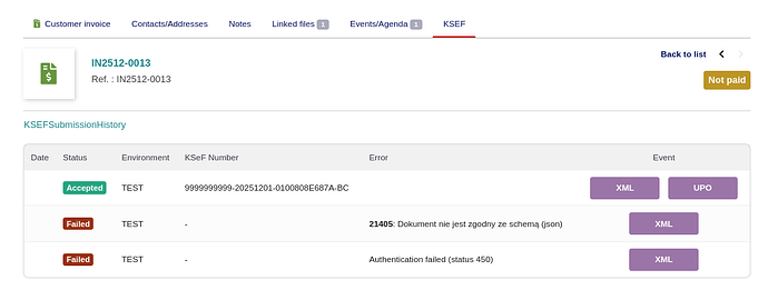

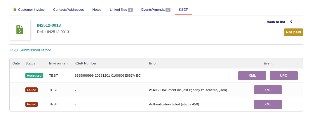

I managed to add a tab that displays the submission information per invoice, but the badge with the number of items I can only get to show up on the main page.
When navigating to the tab, it stops displaying (but the core modules don’t have the issue). I assume there is a somewhat easy solution, but this is a minor bug to address later.
