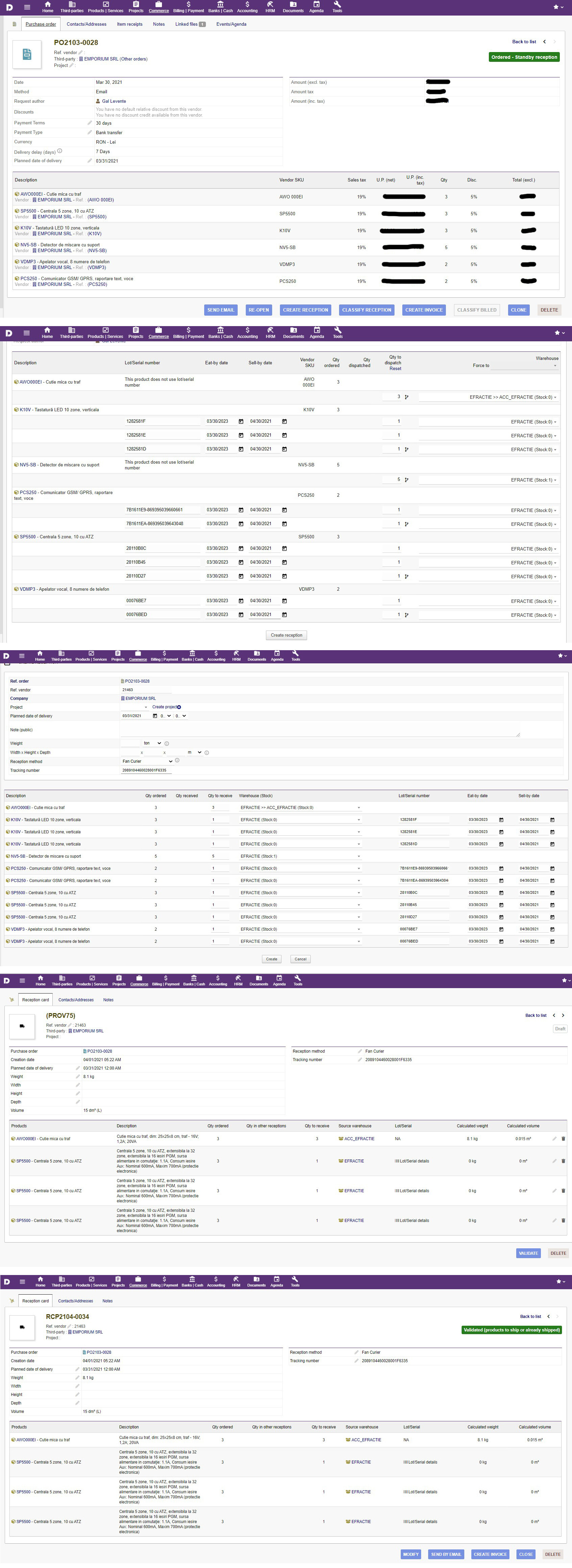

I still have this strange situation with rows disappearing from reception. I think I tried everything I could think of, installed v.13.0.2 as a clean installation and restored the database, changed from Firefox to Edge, checked everything for a million times, and it still happens. I spent hours without any lock, so it seams it cannot continue.
Attached a real invoice for those interested.
