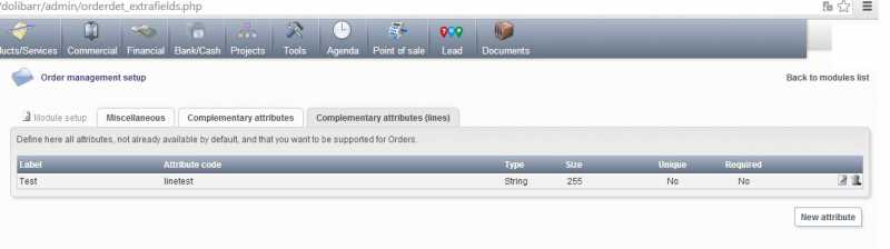

if you make a Complementary attributes field in " Complementary attributes (lines) "
then make a field called “testing”
then on ODT template make {line_options_testing} in row it don’t work!!!
Hey Knut, do you try to display attributes “per each line” = for “each product” ?
complementary atttributes are set up where ? can you post some screenshot where you set up the compl. attribute ?
On the “setup” module “Customer Orders”
Then the Tab
“Complementary attributes (lines)”
Se pictures?
