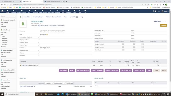

my team did a mistake, they created invoice without creating sale order, is there any way to create sale order from invoice? or create sales order and linked to existing invoice?

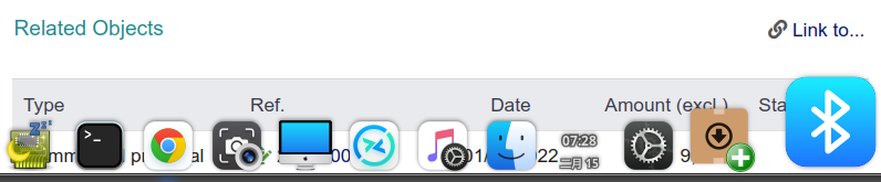

i think you could create a sales order then use " link to " to link invoice .

unfortunately i cannot find this option, is there any settings i need to change to be able to see this option?

In the left hand site of the end " Related Objects "
Many Thanks @trekmorris i’ll test it today. many thanks again.
@trekmorris
thank you, i tested and it work fine.
