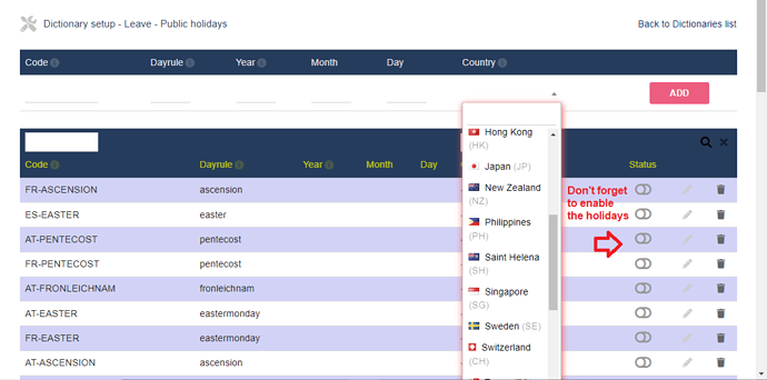

Try adding those holidays in Setup > Dictionary setup > Leave > Public holidays
and enable them.

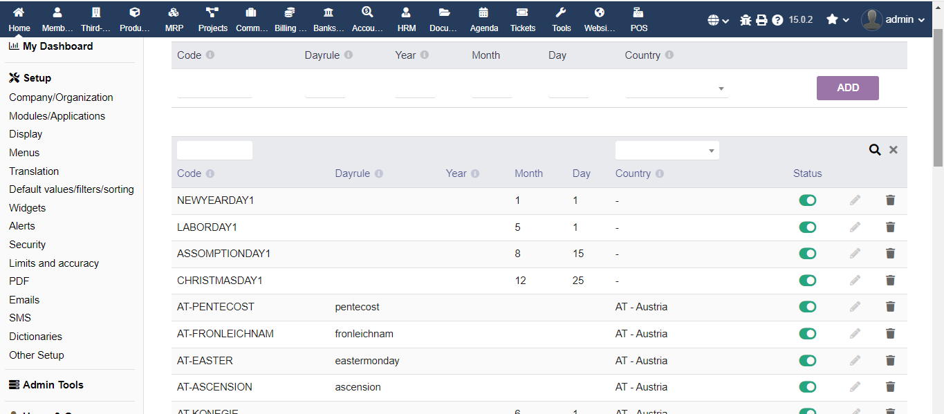

Also, below is SS even in Multi company module. It also doesnot seem to have this feature.
