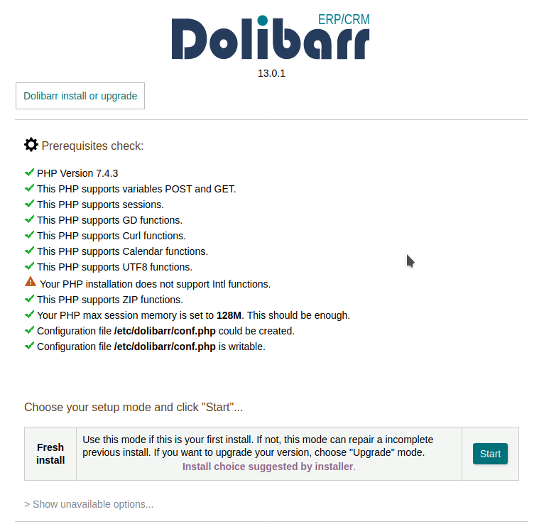

The Dolibarr Wiki says DoliDeb “is recommended for [ubuntu] user with little computer knowledge” - that’s me. I downloaded the .deb package and ran from my desktop it via double click (qapt). I opened “http://localhost/dolibarr/” in Firefox and followed the link to finish the installation process. On the second page I chose the language and got this summary on the third page.

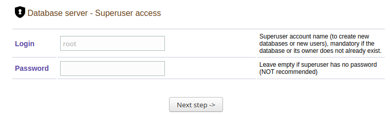

Most values were prepared on page 4 - I just had to enter the database owner password. Then the fifth page presented this error:
“Connect to database fails. Check database server is running (for example, with mysql/mariadb, you can launch it from command line with ‘sudo service mysql start’).
The database connection failed: the host or super user parameters must be wrong.
Go back and check/correct the parameters.”
I tried the suggested service command and restarted the installation wizard without success. Also a restart of the machine had no positive effect. The error appears for various and no passwords (chapters ‘Dolibarr Database’ and ‘Database server - Superuser access’). Unfortunately the hints “parameters must be wrong” and “check/correct the parameters” are specific enough for me. What do I have to do to get Dolibarr running?

look for php.ini in apache folder and remove the semi colon from extension=intl then save it…you can try this…it worked for me…
Thanks for your swift reply. I uncommented the line “extension=intl” and save the file but it did not help. There still is the red exclamation mark sign (intl functions) on page 3 and the error (missing database connection) on page 5.
Then you need to restart apache or reboot the server
But intl is only a warning.

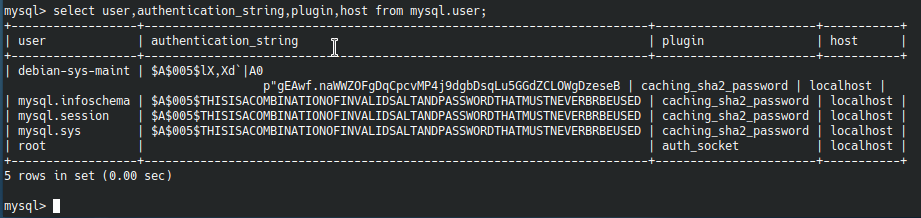

Back to @erikvanberkum’s suggestion from March, 12th: I ran
sudo mysql
and got a mysql propt
Welcome to the MySQL monitor. Commands end with ; or \g.
mysql>
So that looks much better now. I ran the suggested SELECT command and got this output:
What is next?
Just execute that :
Should be OK after to start Dolibarr installation
@ksar not sure if that works in his environment: he runs mysql 8 which uses caching_sha2_password instead of mysql_native_password.
Didn’t have time to check if mysql_native_password is still supported in MySQL 8 or if there are any changes/issues.

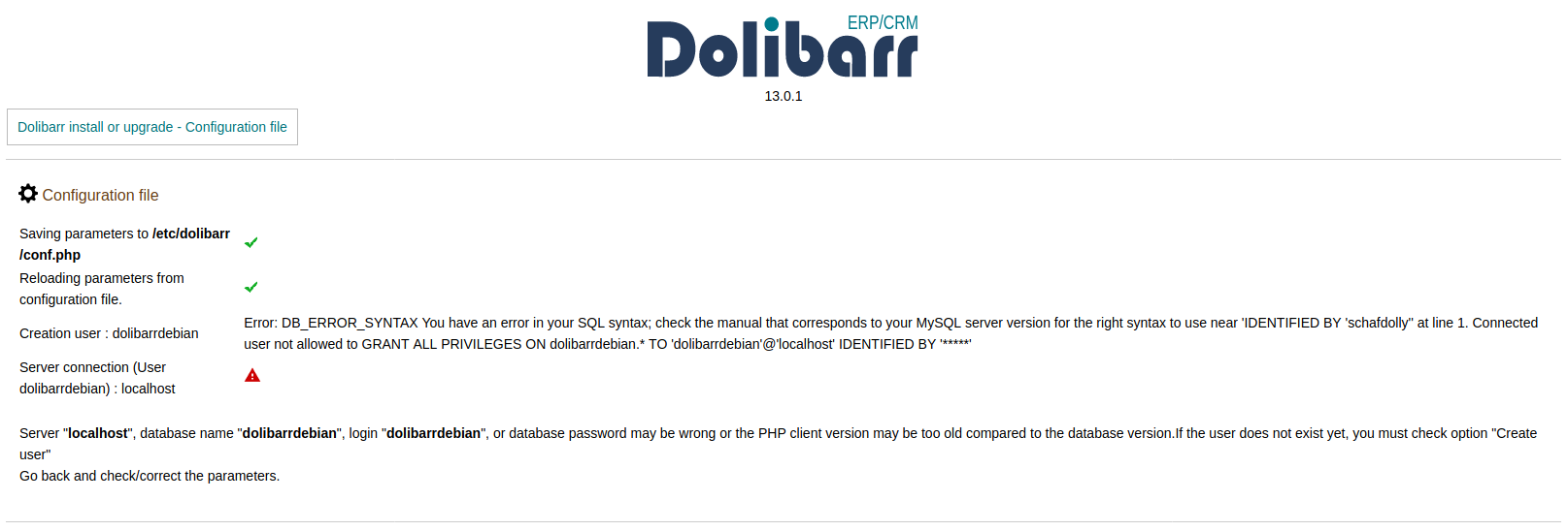

Page 5: New error messages.
(I also got a green tick on “Creation of database (user root): dolibarrdebian”. It is not on the screenshot because I took it the second time I came to page 5.)
So basically this screen gives five possible generic reasons for failure. :frowning: How can I find out what is wrong in my case?
During the last days I searched the internet on how to handle the error “Creation user : dolibarrdebian” shown in the screenshot above. I did not change anything yet but got two new problems:
