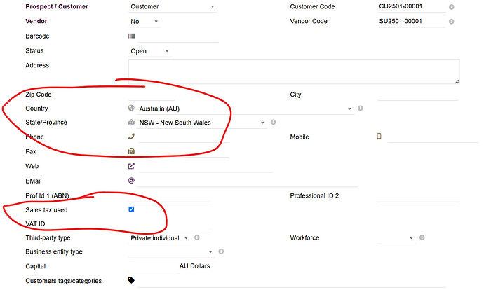

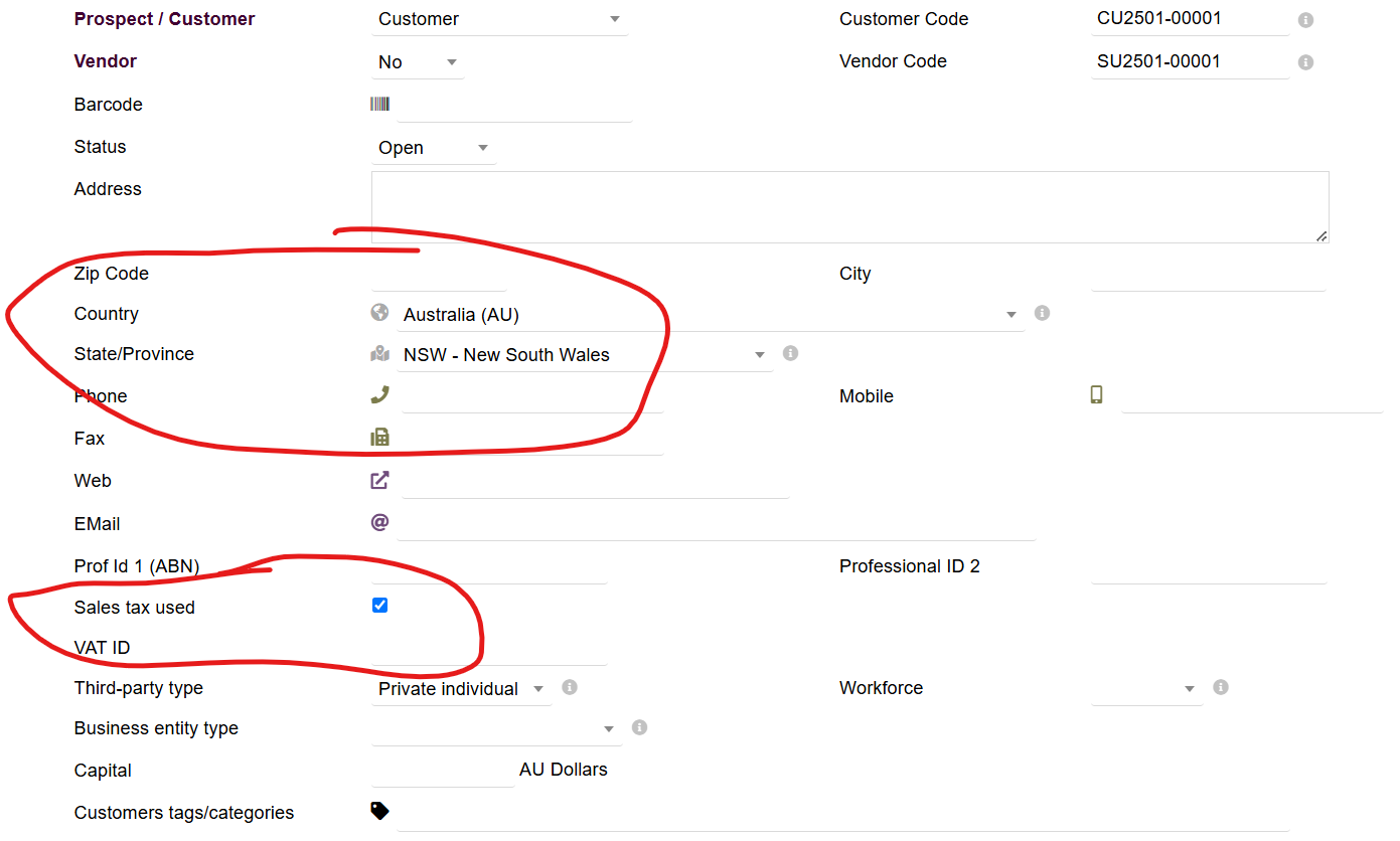

I am also facing a similar issue, Take POS doesn’t show the GST amount. Sales tax has been set up correctly. Anyone can help?
I resolved the issue. Thanks
Perfect !
But the goal of this forum is to share knowledge between users.
Can you explain how ?
The POS customer must have Country and Sales Tax box Checked
