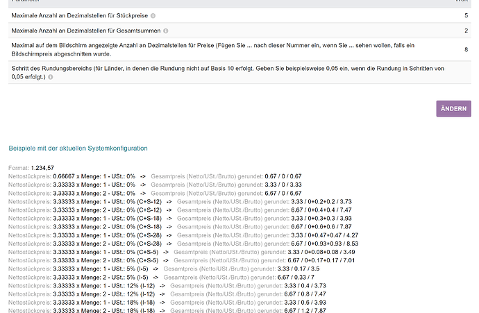

i had a similiar Problem, could you try and increase the rounding Values as follows
Thanks @Plows for your response. Checked and still facing the issue. The final total is not adding up correct.

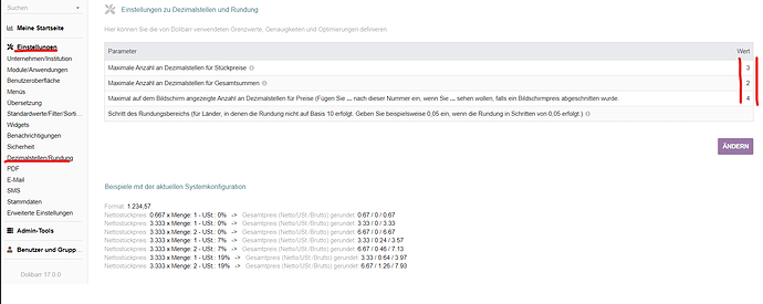

Hi Ash1,
i tried an online Test System (17.0.0)
with these values
but how did you get 4772,50 on line 3? :wink:
Yes, that is because I am using a rounding value of 0.5.
Without rounding, there is no issue. Issue comes only if I set the round off value to 0.5. As here in India, value after decimal is not much relevant. Hence rounding to get a round off number is suggested.
