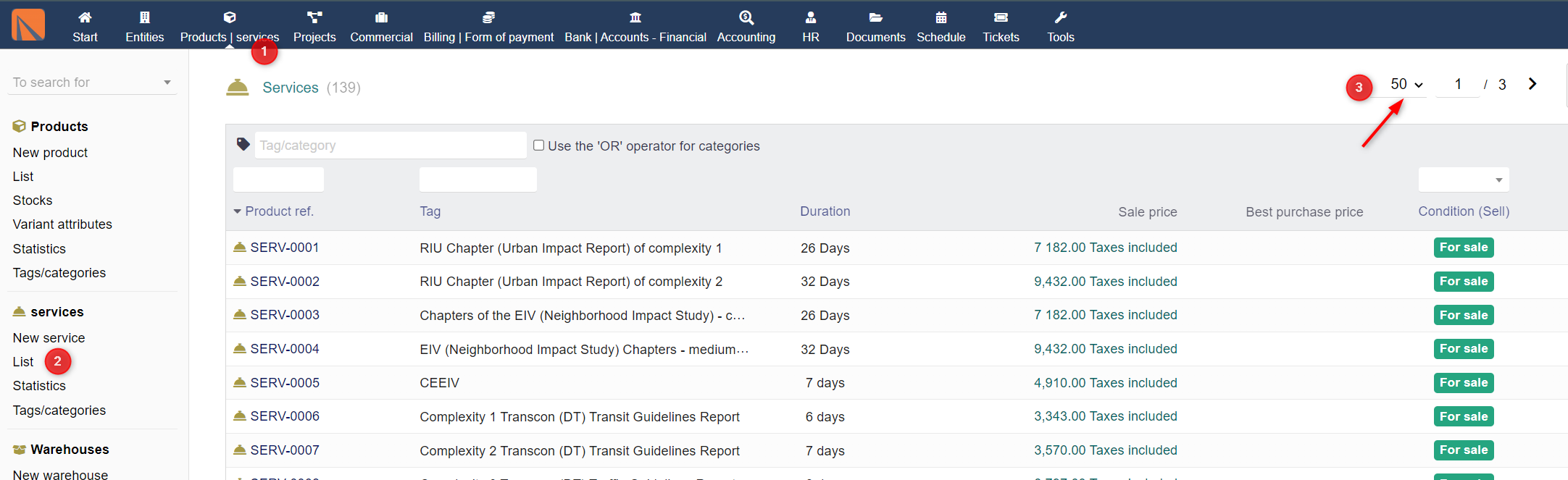

Hello everyone, currently when I enter any list, whether it’s projects, third parties, or tickets for example, it generates a list with 50 rows. I can manually increase or decrease it in the top menu. However, I would like to change this default value from 50 to 250. Where can I make this change? I have already tried to do this in ‘Settings > Appearance > Default maximum length for lists’ and it had no effect.

Thanks, Umigun, for the information. However, after making modifications in my instance, it continues to display a list with a value of 50.

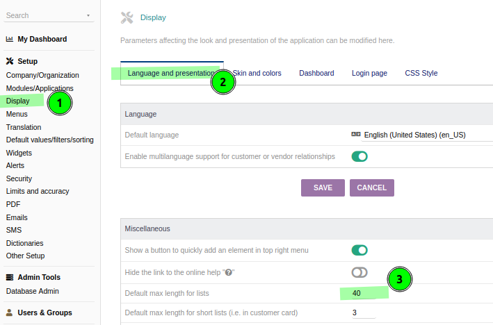

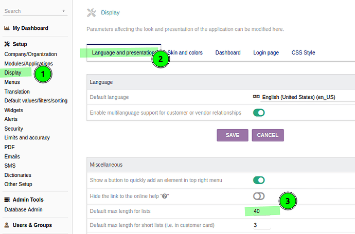

But you can set it manually on:
  • Setup > Display > Lang.& presentation > Default max length for lists

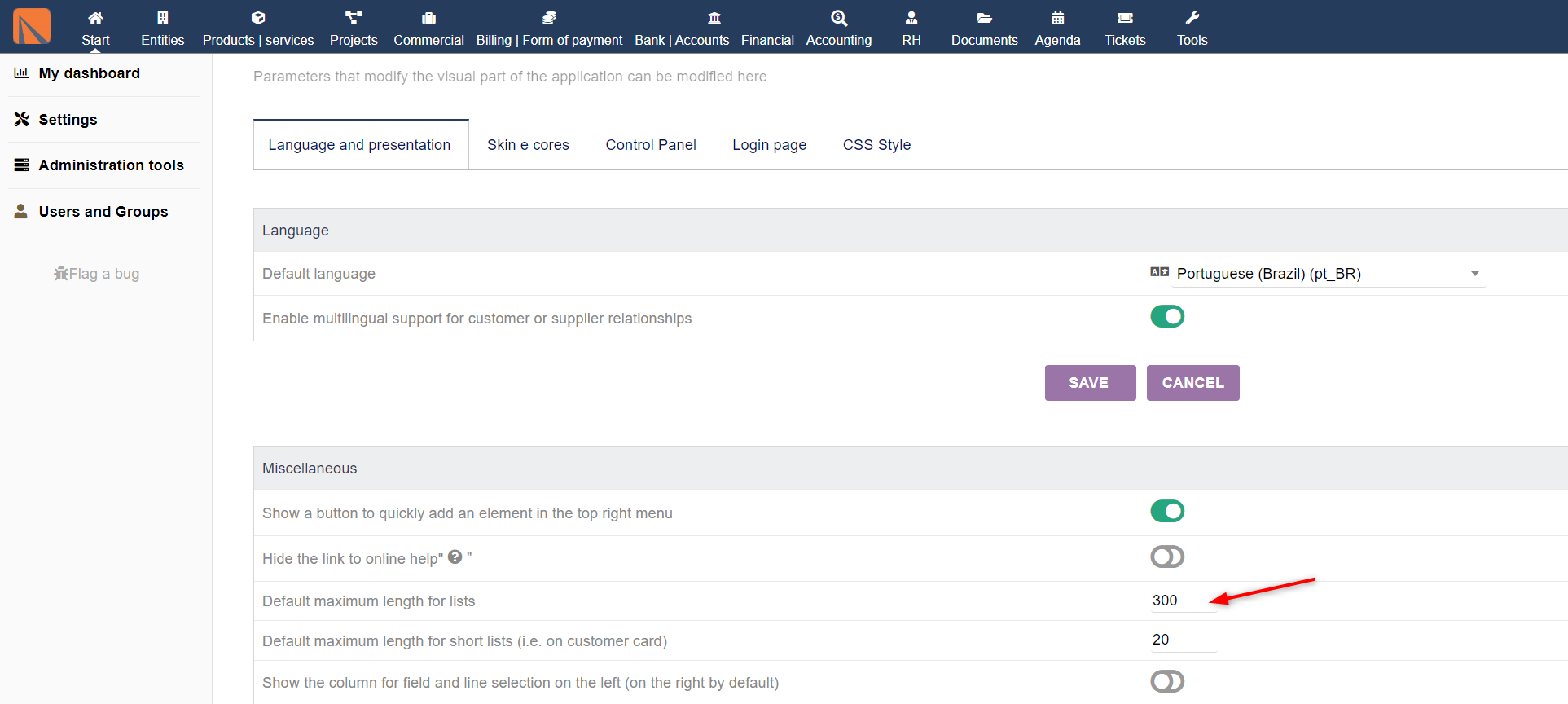

So there must be something wrong with my instance, both with the MAIN_SIZE_LISTE_LIMIT command and the manual way you explained to change the size of my list. See the prints below.

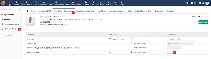

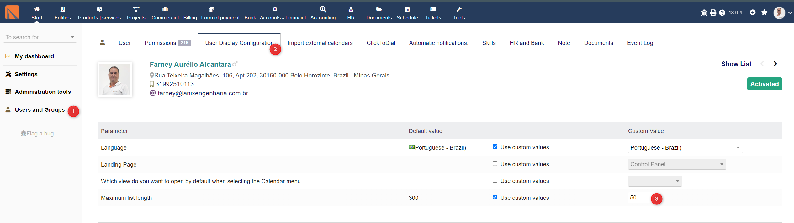

Caos30, you were right, the cache was interfering. But this has brought to my attention another issue: is it also possible to set a custom value per user? When I tested with another user, it worked, but it was still problematic on my account. Then I went to the user settings and discovered this function. Thank you very much for the help.
