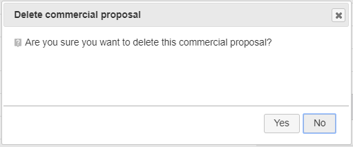

I released since sevral month a module that allows the administrator to remove the confirmation pop-ups that comes too often in my opinion.
Exemple of pop-ups that the module can remove :
Below, please find the pop-up list of what could be removed :
