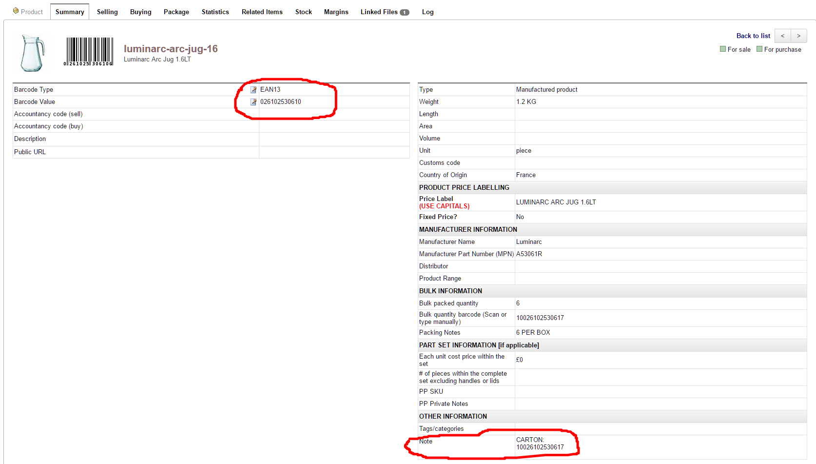

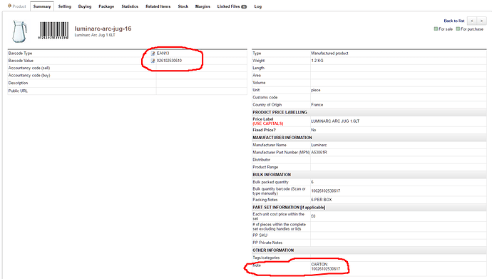

Back to the question, I add the second barcode in my NOTES as the pic shows an example. I have a product barcode and then a different one for the carton. I add the carton barcode into the notes field (in product) so when i search the product (when the goods arrive) I can scan the barcode instead of taking the product out of the carton. This saves me a lot of time. Also, providing each barcode is on a new line in the notes field (WYSIWYG text editor is on in the modules) then I can can ‘pack barcode’ ‘set barcode’ and it is all searchable.
Hope it helps.

Hi Aljawaid,
thanks for the feedback. Sorry, please can you show again the picture because it’s showing the attachment.
Hi Aljawaid,
Please can you show again the picture because I cannot see the attachment.
