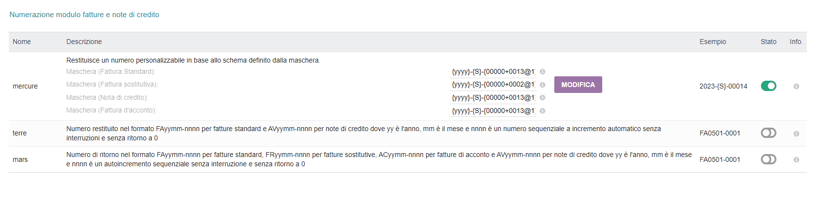

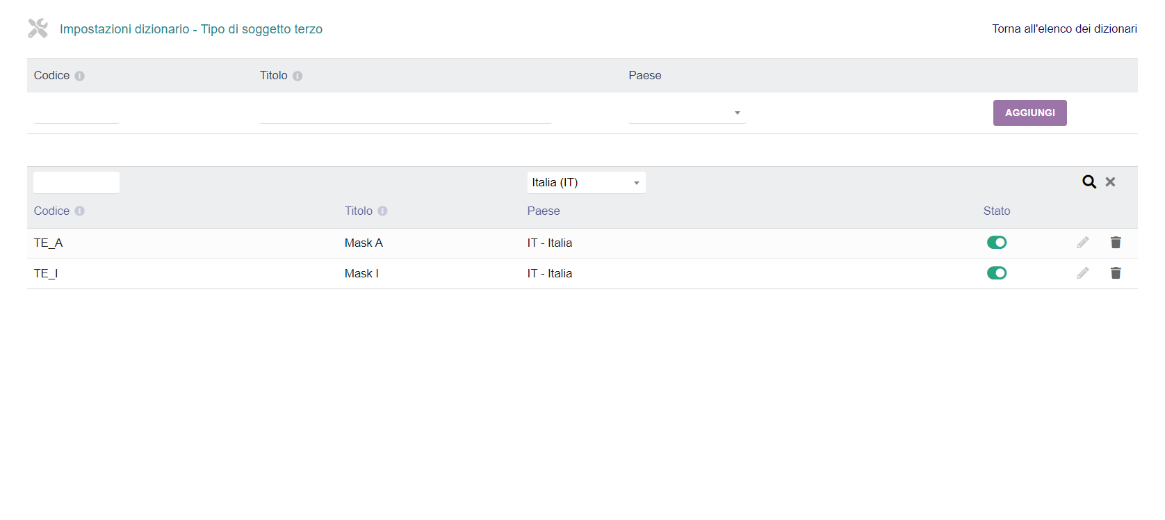

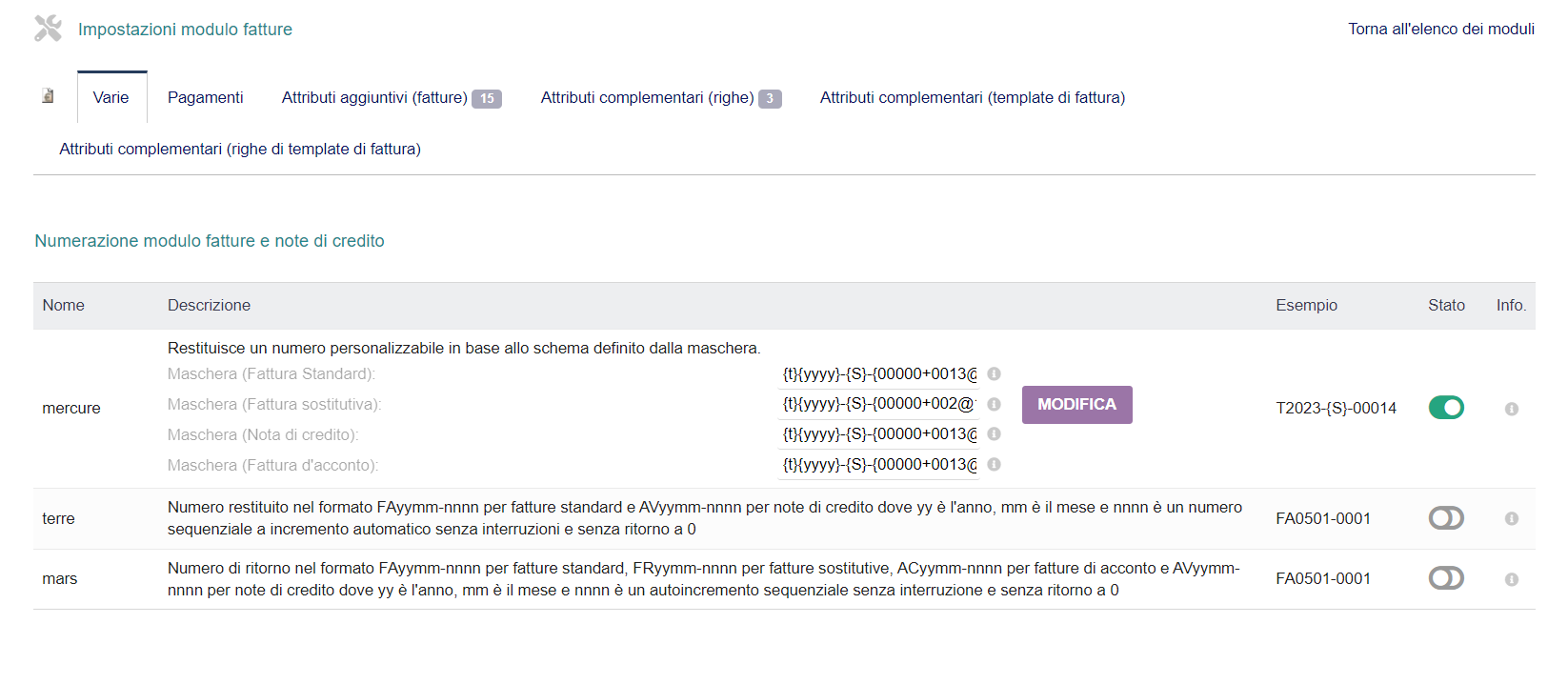

I didn’t put the entire description but it’s there anyway! I attach screenshots

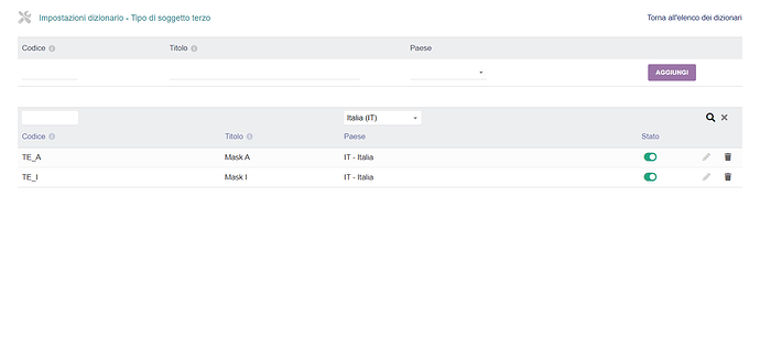

Please provide also your Third Party Types dictionary setup.
Hi @serioga9964
You should change your masks to
{t}{yyyy}-{S}-{00000+0013@1}
{t}{yyyy}-{S}-{00000+002@1}
So for example in standard invoice when you choose “Mask A” you will get T2023-{S}-00014 and when you choose “Mask I” you will get I2023-{S}-00014

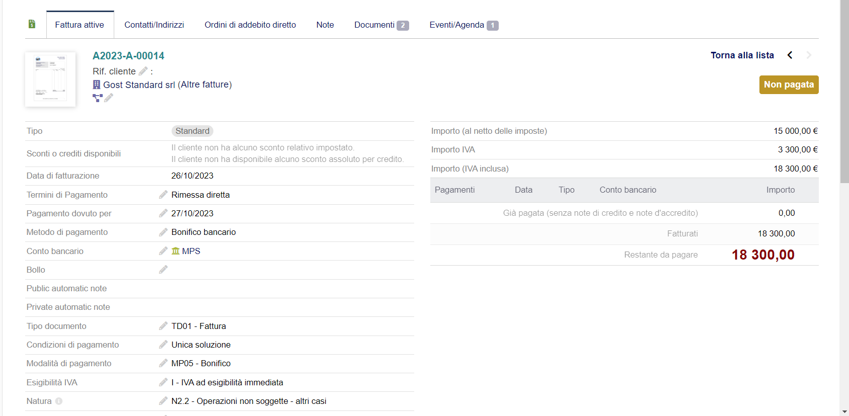

Done, but the problem remain!

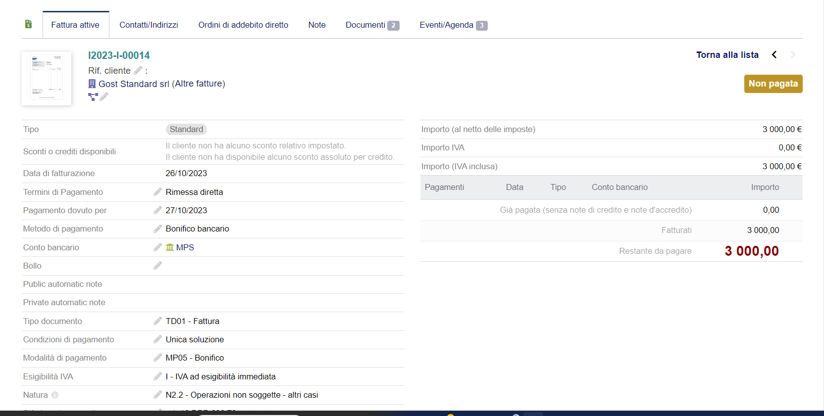

i change the mask (see file prova3) but the number remain for both the 14.
i fill an invoice first with the mask I and the software give me the number 14 (it correct). (see file prova1)
Theu i fill an invoice and choose the mask A but the number remain the 14 (see the file prova2)
then i delet it and fill a new invoice
It is the same number because you chose for them to start from 14. So if you make another 3 invoices with mask I it will go to number 15 then 16 then17, then after that if you make 1 invoice with mask A it will go to number 15

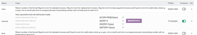

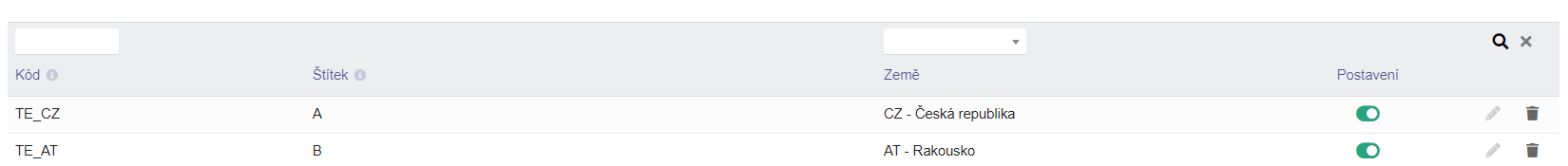

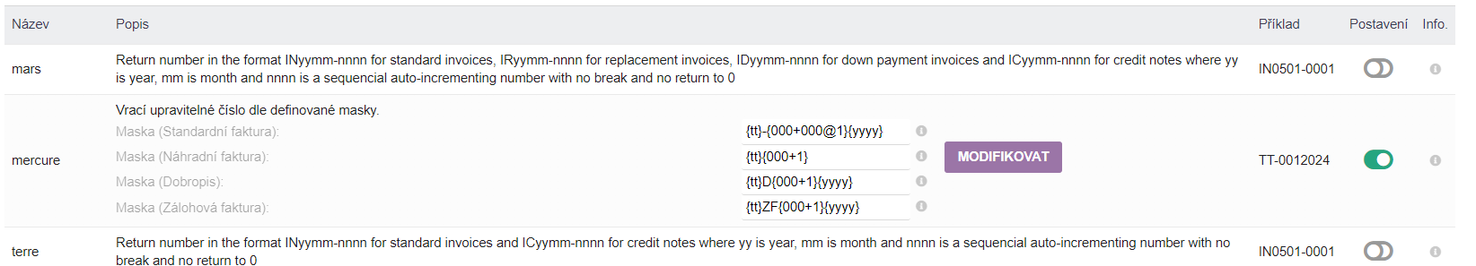

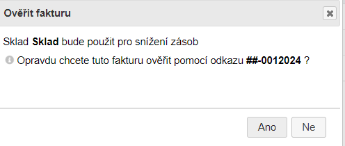

Hello, I’m probably doing something wrong but I don’t see different series of numbers,
settings below
I need it to look like this:
Czech Republic - 0022024 → 0032024
Rakousko- 0022024 → 0032024

Hi @michalhana99,
Everything seems ok from your screenshots!
Did you choose A or B from the series combo box in the invoice creation card?
If yes check also the wiki Support · sonikf/ctpt Wiki · GitHub
Hi @sonikf
It is set according to the instructions posted above. When I set the group for the subject, the invoice number is generated correctly.
I’m trying it on version 18.0.3
