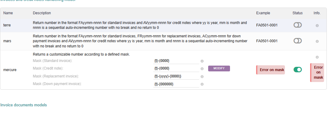

remove the parenthesis and add curly brackets like this {t}-{0000}
This is my existing numbering system FA0501-0001
I want aniother set of series starting from IN-001
both series to use
It can’t be done, either you stick with mars or terre and have a single serial or use mercure with CTPT and have as many but with same pattern.
and how me can configure for existnig serial numbering
You can do {tt}{yy}{mm}-{0000} to keep FA0501-0001 pattern or {tt}-{000} to keep IN-001 pattern but not both

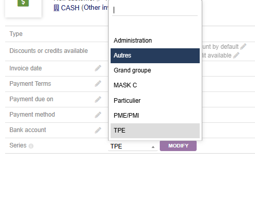

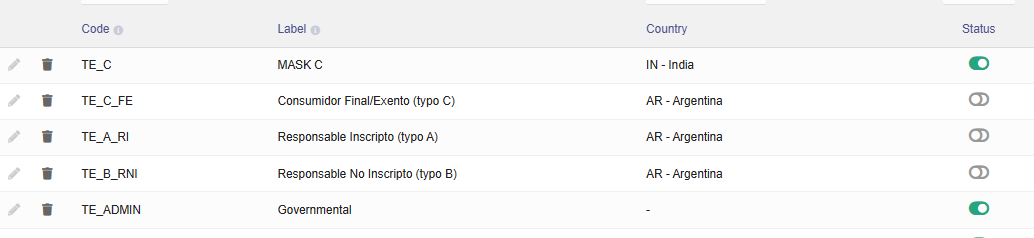

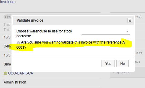

pls see
when me selcet sries administration then invoice with prefix A
how ro configure this default sereiss
Sorry i don’t understand your question please show full screen screenshots
