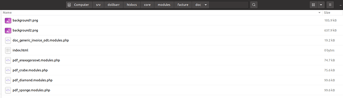

In the process of adding a custom pdf invoice to dolibarr. We have been following all the steps from the various guides and got to the point where we copied and renamded the ‘sponge’ template in the same directory (in our case: Computer/srv/dolibarr/htdocs/core/modules/facture/doc/)

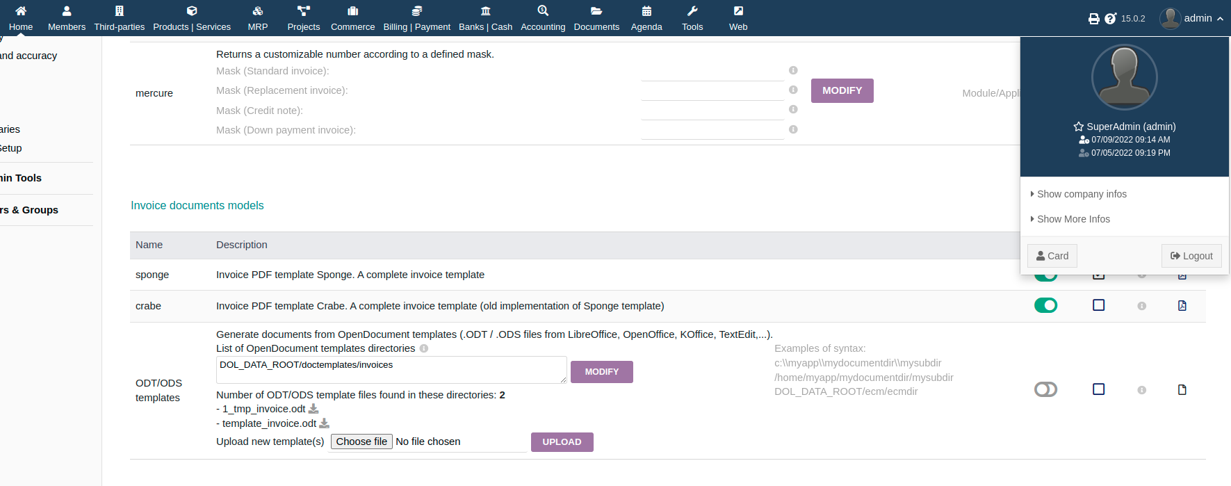

We renamed it ‘diamond’ and made suggested changes, but as it doesn’t show up, we also copied the ‘pdf_anaxagoraswt.modules.php’ file from this discussion: 4 alternative invoice pdf templates - This just to make sure that the reason for the new template not showing up in Home > Setup > Modules/Applications > Invoices > is not related to our PHP skills…
Any ideas as to why the templates are not showing? does anyone have some pointers as to how to troubleshoot an issue like this?

Also, on the ‘Invoices Module Setup’ page that you show above, try making the crabe template the default, by unchecking the sponge ‘Default’ checkbox and checking it for crabe, then disable the sponge template by using the switch on the Status column. Then restart your web server and clear any cache in your browser and refresh, to see if the Anaxagoras template shows up. In Dolibarr 12, which I’m using, it surely shows up. If it doesn’t show up for you, it might be an odd bug in Dolibarr 15 or other odd issue that you might have in your installation. Please let me know how you solved the problem.

Many thanks for your reply! You surely put us on the right track. We checked the dolibarr status from the ‘admin tools’ and we noticed that indeed we should be looking at another directory all toghether:
We needed to be at: ‘computer/usr/share/dolibarr/htdocs/core/modules/facture/doc/’ not in ‘srv/dolibarr…/etc’
Beginners mistake I guess, but would you be able to shed some light as to why there are 2 exactly the same file structures on both srv/ and usr/ ?
The ‘diamond’ template showed up right after we uploaded it to the correct folder this time. The Anaxgoras however only showed up when we manually added it to the the 'llx_document_model" table.
