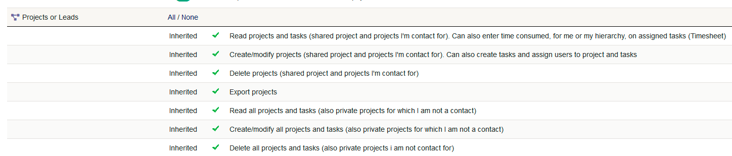

It might be permissions. Check out your user card. Go to the Permissions tab and scroll down to make sure that you have Projects permissions.
Thanks, the permissions were OK, but I have already solved the problem. The menu manager was not working. I restored de recommended menu, eldy_menu, and the Projects tab is shown on the top menu.
