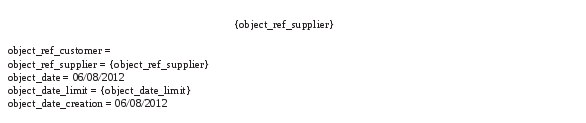

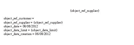

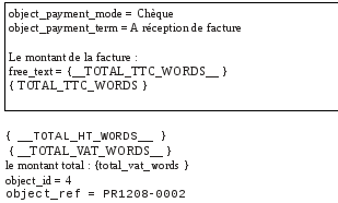

this is somes screen capture,
1
2
3
and the second , this propoal is to send to a contact (e.g greg ) in a company , but i dont see her {civility} {firstname} - like a model azur
or for example, is it possible to use a default {company_contact_civililty } and {company_civility}
in the last,
and intgrate a photo for select product in the current purpose ? is it possible ?
thank you again.

You must use
{TOTAL_VAT_WORDS}
and not
{TOTAL_VAT_WORDS }
remove the space. Also be sure to write the key without copy-paste and without pressing back during typing.
hi eldy, thank you,
with odt generator total words are [OK]
