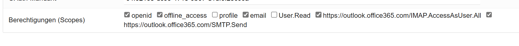

i am using Dolibarr since Version 19 with Office 365 Business Standard E5, of course it was not easy at the beginning, but with the help of this forum i got it working like a charme, especially for the ticket system.
No need for the developers to change something, my environment at the moment is as follows
20.0.3 on Ubuntu 20.04 with PHP 8.2.27 and nginx 1.27.0
Microsoft Oauth2
with acitvated PHP-IMAP instead of the native imap
my scopes are as follows

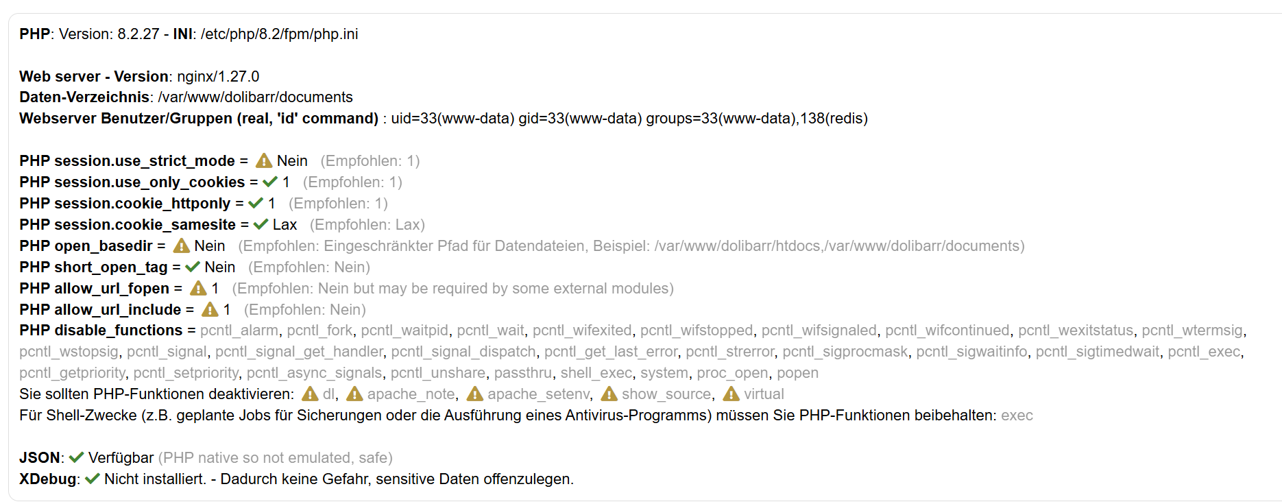

keep in mind the PHP Settings i needed to change some settings
