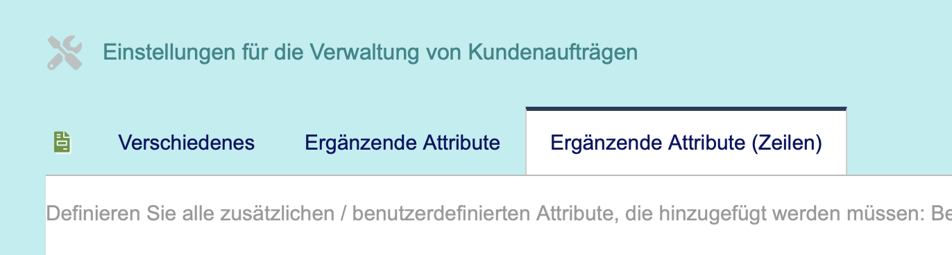

I add an extrafield in the Module Commande and there I add it for Lines:
Now I want to have the Line ID in this field.

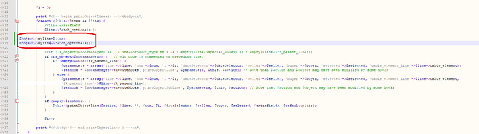

I did some tests to achieve what you are looking for, but in fact it seems impossible without making some changes in /core/class/commonobject.class.php - in version 16.0.3
by adding these two lines you can use this formula to find the id of the line in your cmputed field
“$object->myline->rowid”
Using a hook on printObjectLine, this could be another solution for doing this
