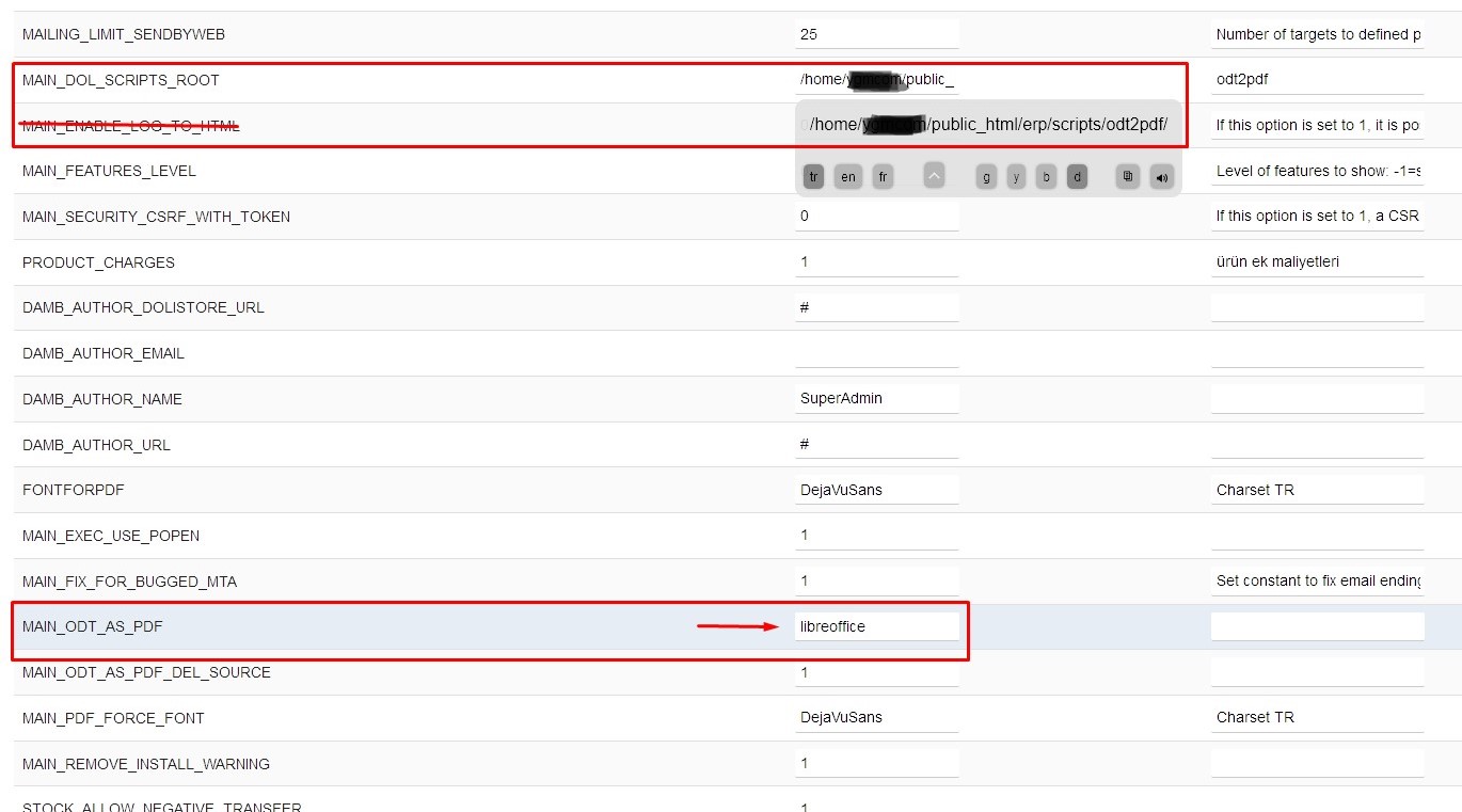

I tried this solution published by ### h6585 . (of course all other solutions didn’t work)
https://github.com/Dolibarr/dolibarr/issues/10896
MAIN_DOL_SCRIPTS_ROOT = /home/xx/public_html/erp/scripts/odt2pdf/
MAIN_ODT_AS_PDF = pyodconverter
file dir : /home/xx/public_html/erp/scripts/odt2pdf
odt2pdf.zip (5.4 KB)
Host PHP-FPM setttings: exec,pasthru,shell_exec, system = allow

yes i finally found a solution thanks you priojk
Apache (Ea4) / WHM-Cpanel * install openoffice
wget Download Apache_OpenOffice_4.1.12_Linux_x86-64_install-rpm_en-US.tar.gz (Apache OpenOffice)
tar xzf Apache_OpenOffice_4.1.12_Linux_x86-64_install-rpm_en-US.tar.gz
cd en-US/RPMS/
rpm -Uvh *.rpm
then the above steps
now makes your ODT templates PDF on server side. Our purpose is clearly for mobile users and those who cannot read ODT documents and therefore without installation provisioning such as openoffice, libreoffice.
