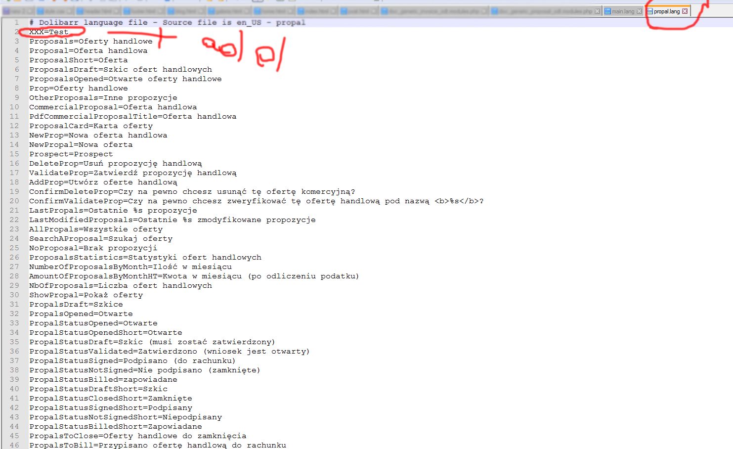

langs/en_US/propal.lang - add test=test translation

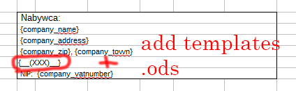

documents/doctemplates/proposals/template.ods - add {(test)}
Generating a document. The translation should be displayed(test translation), and is displayed {(test)}

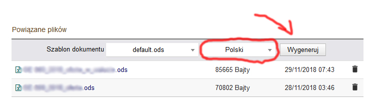

I want to set up a 2 language skill in the .ods template.
If you choose, for example, Polish, the text will be displayed in Polish.
And if I choose English, the text in English will be displayed.
Type of text: Buyer, description, etc.
The language does not work when the document is generated.
Only the default language works

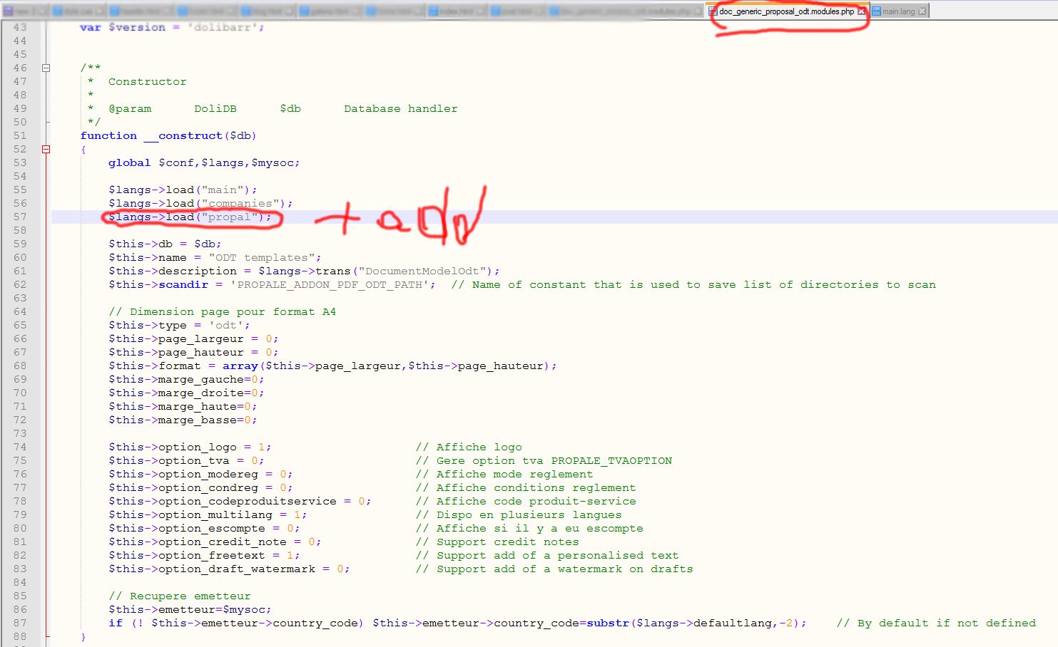

If you modify propal.lang, you should include $langs->load(“propal”);
I’ve included in the doc_generic_proposal_odt.modules file
$ langs-> load (“propal”);
And further in the generated template it does not display my translation.
In Attachment: pictures what I change
