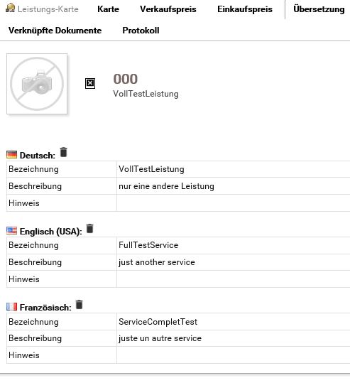

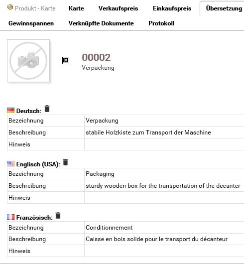

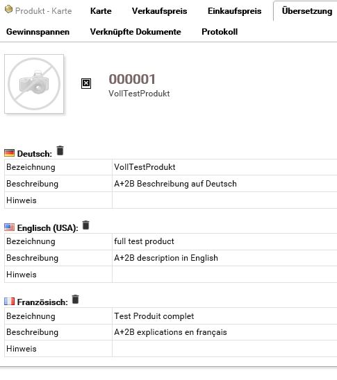

Here I attached 3 pictures of my Problem.
What I do not understand is that the ODT offers that I get are with completely mixed up languages. See the attached screenshot.
- screenshot of 1 Test Product with translations
- screenshot of 1 test Service with translations
- screenshot of one product called Verpackung with Translation

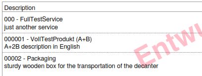

- screenshot of an ODT offer for a French Client
- screenshot of exactly the same offer with AZUR template.
thanks for your help
Pièces jointes :
And I have now another example with an offer for an Enlish speaking Client with the 3 same product/Service than the previous example
- ODT file
- file with AZUR template
Pièces jointes :
