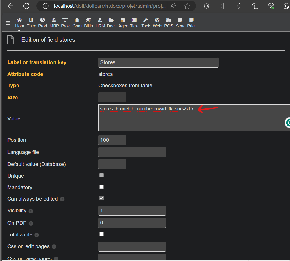

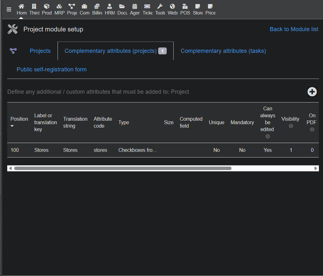

Sorry, I thought that I explained a little bit more. Anyway, I will explain now:
I created a new module called “Stores” module. and already in the system there is “Project” module. So now when i create a new Project I want to assign it to many Stores directly and i want this to be done through Selector of multiple values. So, in my mind that i can add a new attribute to the Project module on its setting page in “Home → Setup → Modules/Application → Projects or leads → setup → complementary attributes (projects)” but here when i want to create the new attribute i don’t know how to add it as a multiple “link to an object”.
I hope that i could explain it.

@ksar This what i meant. I added the new Stores selector field but the point here that in the creation of the Project the selector of Stores is added successfully but also i need to filter the Stores list according to the chosen Thirdparty. So in the new attribute ypu can see that i added fk_soc=515 which needs to be replaced with the right value of the chosen Thirdparty. Do you have any idea?
Hello @ksar ! About the last issue i sent, in the documentation, they said that i can use $ID$ but i want to use Thirdparty so i tried to use it like this: $Thirdparty$ but i didn’t work and it says:
Error in request SELECT rowid as rowid, b_number FROM llx_stores_branch WHERE fk_soc=$thirdparty$ Unknown column ‘$thirdparty$’ in ‘where clause’. Check setup of extra parameters.
Do you have any experience with this?
