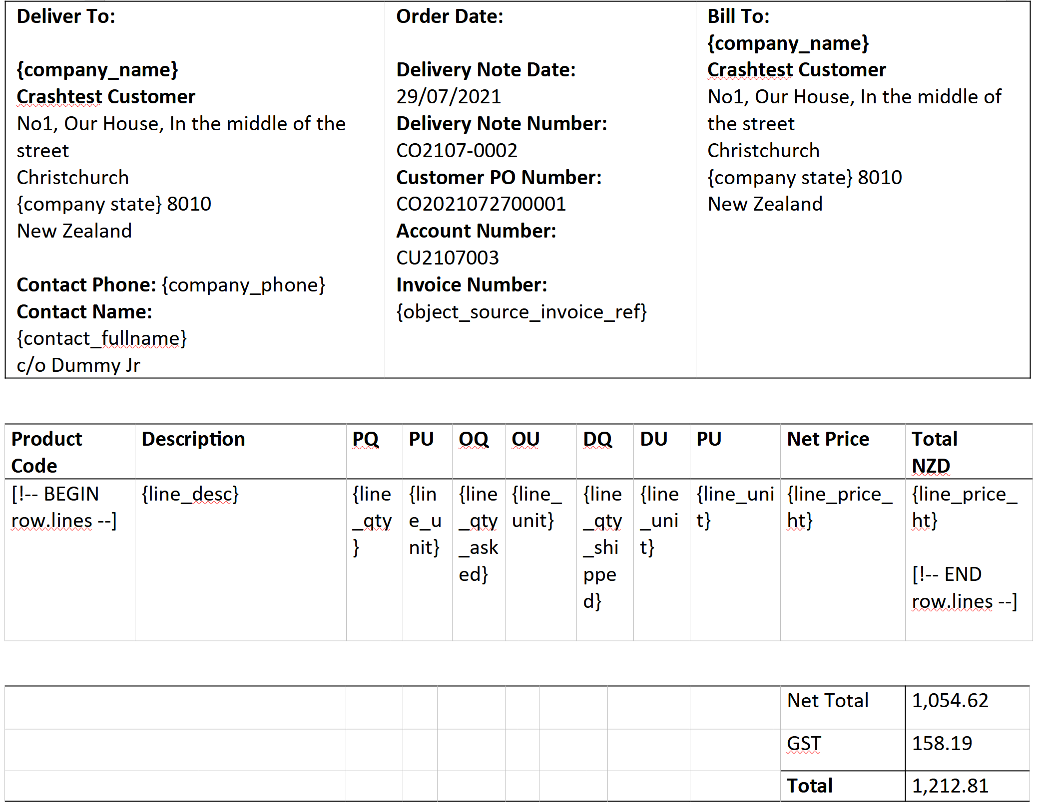

I’m using Dolibarr v13.03 but am having problems with the .odt templates. You can see in the image that some tags work okay but other do not.

Have you try Crtl+M to remove direct formatting from Tags ?
If that was ok , you may upload your odt file , so i could test it .

Unformatting has gone some way towards correcting it. There are some, however, still not correct. The company address is now fully working. {company_name} and {mycompany_state} is also working now but {company_customer_code} and {object_source_invoice_ref} are no longer working.
{line_full_desc} doesn’t work and {line_desc} returns the product origin country. Lastly, {line_unit} and {line_unit_short} do not work.

Have you check the tags on wiki ?
Like the {company_customer_code} , i could just find {company_customercode} on wiki .
Do you create the odt by yourself or you get the odt template from other people ?
Some tags seems a little change , so you need to check that on wiki again .
{object_source_invoice_ref} seems only could be used on invoice not on shipping .
Like this situation , i will recommand you to create a extrafield on shipping module .

@trekmorris, thanks for the feedback and the tips. Yes, I’m using the wiki. {company_customer_code} was a typo on my part. Thanks for the tip on creating the extra field to bring the invoice object into the shipping object. I will try this. Thanks again for the help :smiley:
