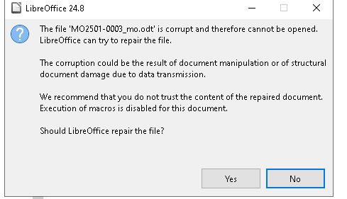

Did you find a solution? I am having a similar problem. When I generate the .odt file from a template in Dolibarr, the generate file is corrupt. I do not think it is related to the odt->pdf conversion, because this happens after the file is generated for Dolibarr.
Using LibreOffice the template opens with no problem, however opening the generated file LO reports it has corrupted.
Using Dolibarr 20.0.3 and PHP 8.2.22 on Windows Server.
This is the Error from LO.
The problem occurs after the .odt document is edited by LibreOffice.
