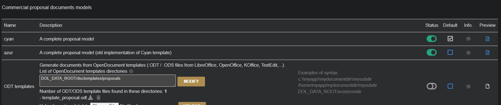

Please see attached image. We have the ‘cyan’ and the ‘azur’ templates active, and cyan set as the default. This new server is almost an identical clone to what was on the old server, etc. I can’t find any external/third party modules driving this additional terms/conditions/signature section on the Commercial Proposal doc on the old server, so that’s what brings me here.
Cyan or azur doesn’t add pages on PDF so, either you have another model on your old server or it’s a modified version of Cyan or Azur
Thanks for replying. Agreed, that’s what I was looking for, was some type of modification. I even attempted to overwrite the cyan/azur modules in the core directory with what was on the old server, but alas. No changes.
hello, maybe you had the concatpdf module installed ?
