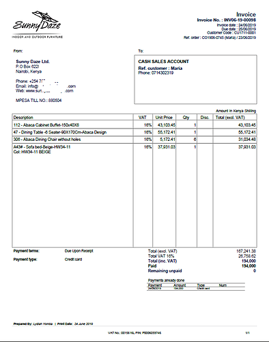

pdf_crabe_module (invoice pdf template)
This is my template for invoice (pdf_crabe). This template is good for those printing in black and white for example with dot matrix printers with continuous perforated paper.

How can i edit this PDF as i need to add Line No. before description and need to adjust Qty and Unit price column display order.Qty Column should be first and Unit price price to be followed
Hi Arshadez,
See attached pdf template, I have switched the order of qty and unit price. I don’t know how to put in line numbers, however. There is a template in Dolistore with lines:

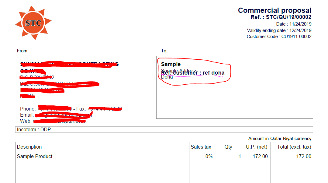

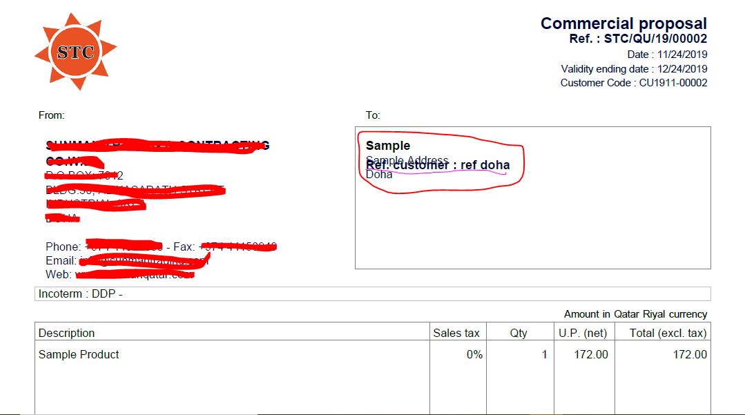

the attached template is generating Fine,But customer ref. was appearing inside customer details box.please see and kindly correct it and resend me the both modules.(Pdfcrab & pdfazure)

Hi arshadez,
I have modified the pdf_azure see link: https://transfernow.net/13e279f1pm5j
For pdf_crabe no need it displays address correctly
