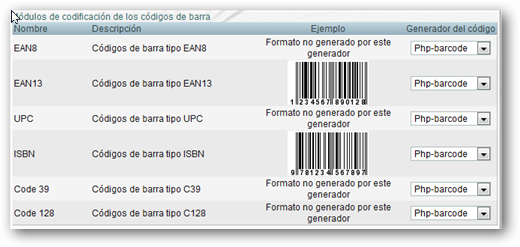

Acabo de Instalar Dolibarr 2.8.1 y tengo una preguntilla sobre la generacion de codigos de Barras.
Por defecto el modulo solo tiene la biblioteca PHP-BarCode y solo puede generar los tipos EAN13 y ISBN
Desearía si pueden indicarme, de donde bajarme e instalar una biblioteca que acepte los otros formatos.
Tambien estoy inmensamente interesado en poder generar los “nuevos” codigos de barras en 2D para los Productos y Clientes (dado que tambien cabe mas informacion como el numero de serie o la URL.
Saben si existe y de donde conseguir la biblioteca PHP o modulo para generar dichos codigos?

I just installed Dolibarr 2.8.1 and I have preguntilla on the generation of bar codes.
By default the module only has the PHP library, and can only generate BarCode types EAN13 and ISBN
I wish if they can tell me, where I download and install a library to accept other formats.
I am also immensely interested in being able to generate “new” 2D bar-codes for products and customers (as well as more information can be the serial number or URL).
They know if it exists and where to get the PHP library or module to generate these codes?

Take a look at www.dolistore.com
You can download new modules. Among them one other barcode generator that support more format. But needs Dolibarr 2.9.
Sorry I’m not an IT profecient. I downloaded this one, put it into the root, but when I apply the code nothing happens. My dolibarr is installed local als WAMP. How can I install ? I have modul already decompressed but it also not appera at Home - > Modules -> Barcode and than choose option
I’ve done. I decrompessed local and than copied the files in the properly folder…
