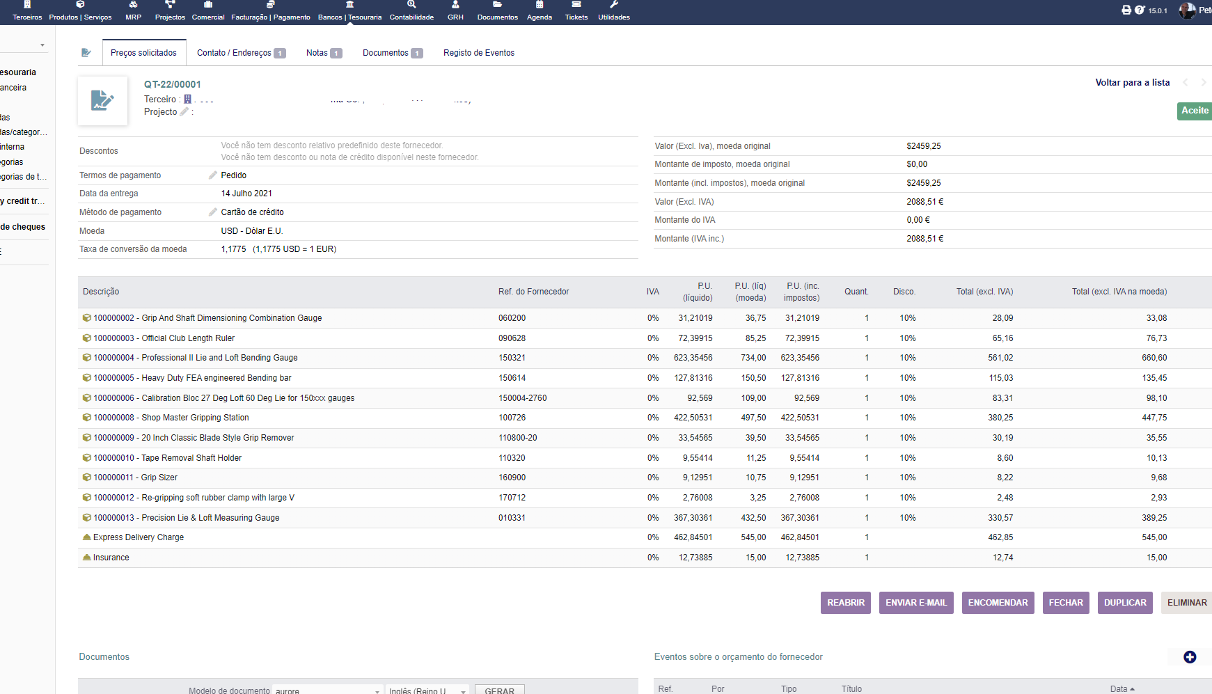

  1. Here is my Quotation request all filled up and nice with the suppliers’ prices. Counter value in Euros at the date of this quotation receival is just informative for now, nothing more. As you can see the total amount of the order of $2459.25 is the proposed value from the vendor. This is what he will expect me orther the products for.

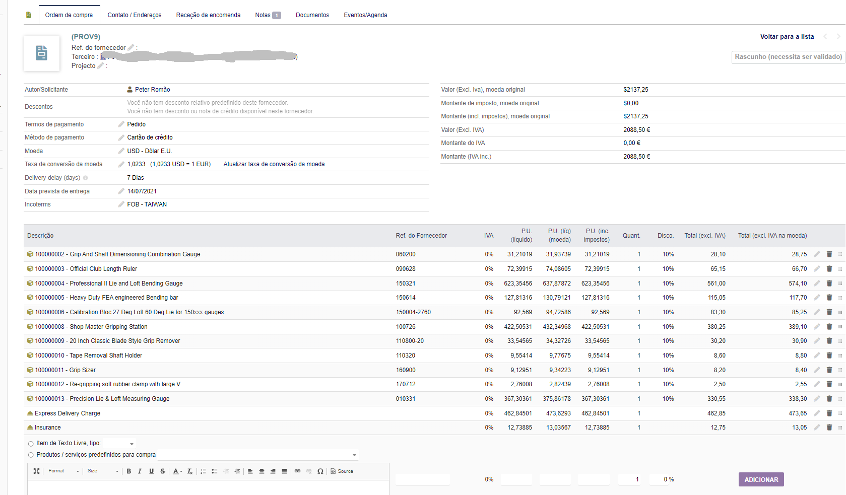

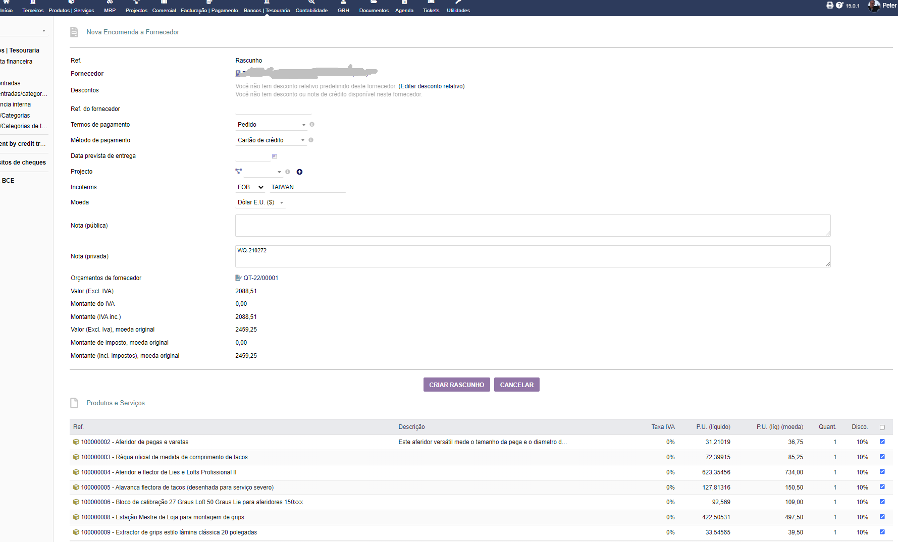

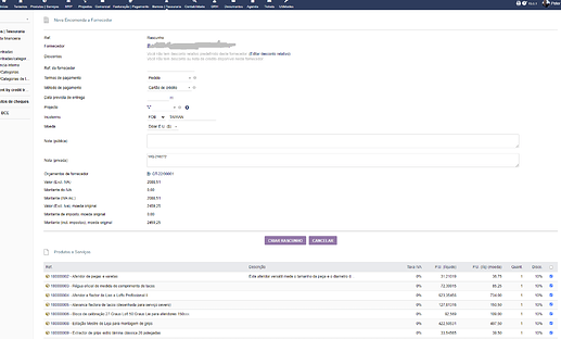

  1. When I press the place order button there is a new display representing an intermediate step in the process. Here I am in an instant just before creating the Draft of the order. As you can see the values of the line items in the vendor’s currency are all ok. At this time they are shown based on the rate at the time of the proposal validation.

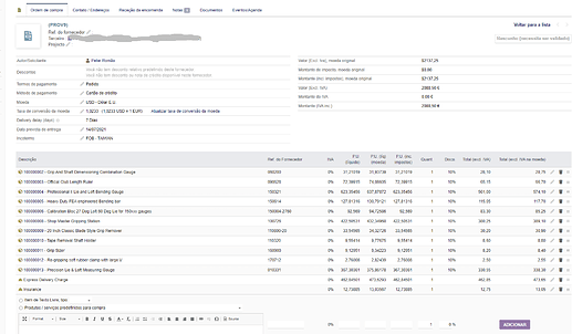

  1. As soon as I press Create Draft all hell brakes loose. As you can see from the display, the currency rate reverts back to the present rate which makes some sense but all the prices com affected from it. In effect the supplier’s prices are now calculated from the base currency (Euro) that came from the proposal (it shouldn’t if the vendor uses another currency) and the difference renders the order to my supplier useless. See both the totals and the line values in the order draft.
The way I see it the Euro prices should be reflected by the current currency rate, yes, but the vendor currency prices should be the driving numbers in this instance. Currently I can never validate this order and send it to the supplier without any line by line editing. It’s very cumbersome.
