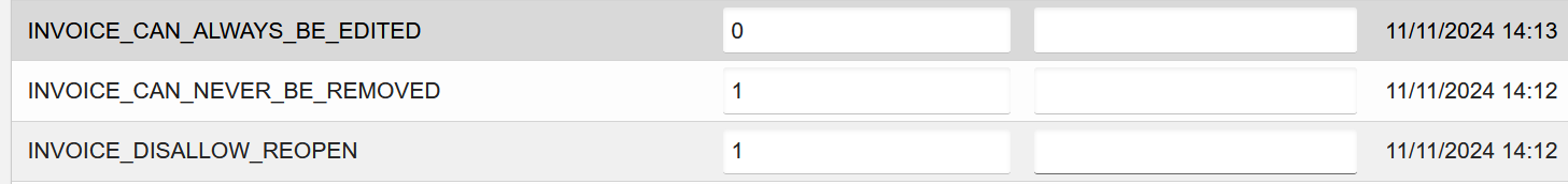

I want to prevent users from modifying invoices after signing those. I’ve tried adding some of the options I found for Configuration-Other but none of them achieve this: INVOICE_CAN_ALWAYS_BE_EDITED, INVOICE_CAN_NEVER_BE_REMOVED, INVOICE_DISALLOW_REOPEN… No matter what I do, invoices can always be modified. I also tried enabling unalterable files with no luck.

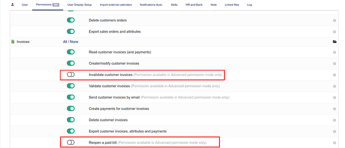

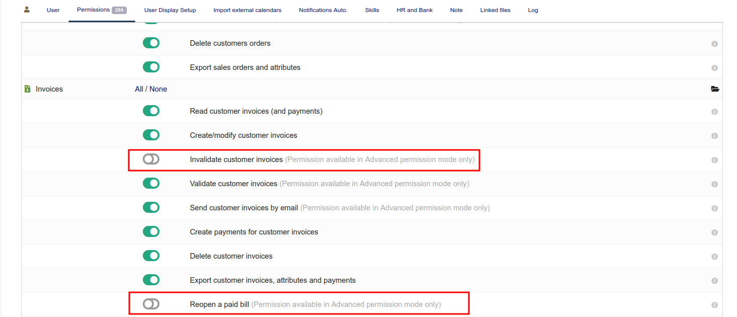

This is what i see in 19.0.3 with MAIN_USE_ADVANCED_PERMS set to 1
Uncheck both highlighted options and no one could re open an invoice again…
I have the multicompany module enabled, and MAIN_USE_ADVANCED_PERMS had to be enabled for every company, not globally for both. I wouldn’t have realized if it weren’t for your image.
