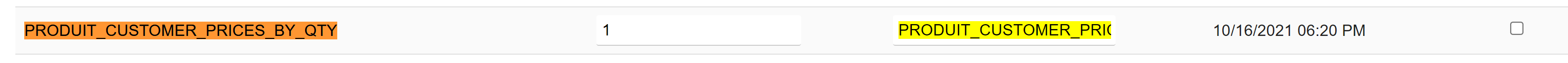

IT IS working. Do following:
  1. Go to “Home > Setup > Other Setup”
  2. Paste “PRODUIT_CUSTOMER_PRICES_BY_QTY” in columns 1 and 3 and “1” in column 2 (see attached) and click the “ADD” button.

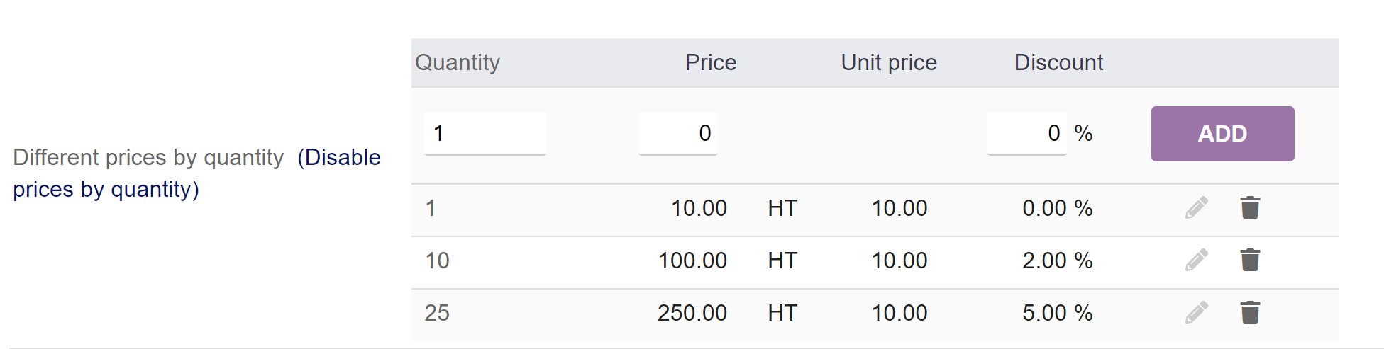

  3. Go to some product > tab “Selling prices”. Below the current price, you can see " Different prices by quantity (Activate)"
  4. Click on “Activate”
  5. Have fun. )see second attachment when the feature is activated)

Problem is that it is fixed for these quantities.
It is normal to have lower per 1 prices if you buy more than x pieces.
Yes, and with this behavior, if you change the quantity in the order, the price remains unchanged.
For example, if a product is worth 10 euros per unit and 10 units are 90 (9 euros per unit), if I put 10 units and then lower it in the order to 8 units, they are still worth 9 euros.
As it works right now this module doesn’t make sense, and it is a very basic functionality for an erp.
