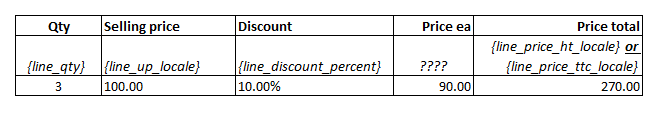

Price ea means Price each ( Selling price - discount ), because when i use the other line_xx it always summarize the amount if qty. is more then 1.
I’ve attaced a screen how i need it.

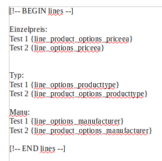

I tried two different ways:
a) to define a range/field with line_price_ht_locale at the ODT template and text formel ( line_price_ht / line_qty ) but it failed

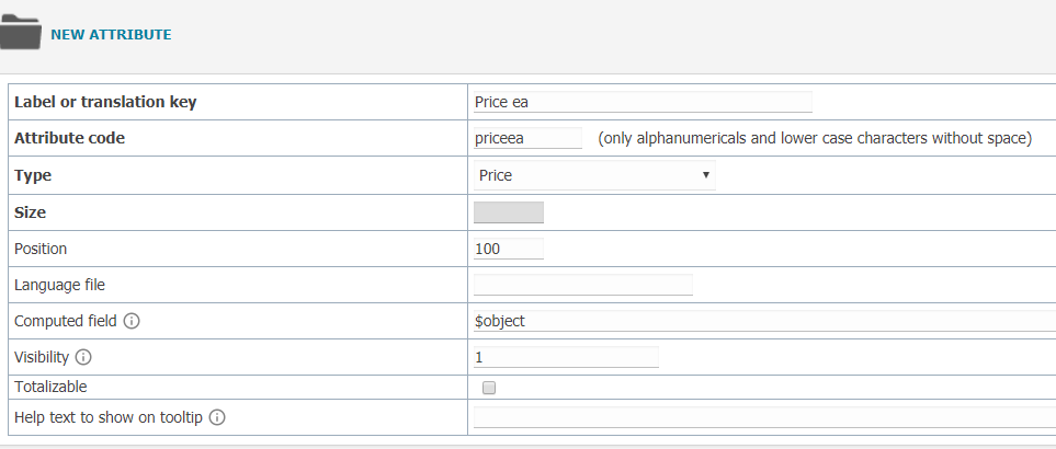

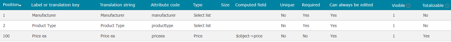

b) an extra-field on product with Computed field but however it is not working on ODT output

However, it do not show any ouput on first line ( where i expected the price ea ), and also the other lines are, maybe OK but instead of showing the name of entry it show only entry itself.
Any idea how i can get this field adopted right into our ODT ?
