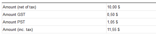

First off, here is what you get in the order card when you make a draft

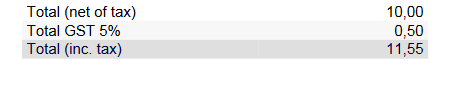

Now, here is what you get with the default template, muscadet:

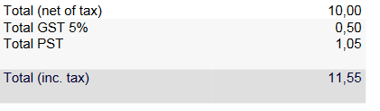

I parsed through the template code and found out that if there is a first sales tax (defined as VAT all the time in the code, which is a little bit bothering to work with), it will add sales tax 2 and/or 3 to the total, but it doesn’t seem to print them. The function to print them only works if ( and that’s the way the original code works) the first sales tax (VAT) is 0. That was seriously puzzling to me.
I edited the code for my own template. Had to add an extra table row, and modify the other items to be displayed (Total net, tax 1, and grand total) to be displayed taking the extra line in account. Here is what it looks like:
And here is the code I modified:
In function _tableau_tot
Under global config, I edited table values to add an extra row
        $tab2_top = $posy;
		$tab2_hl = 4;
		$tab2_hl2 = 8;
		$pdf->SetFont('','', $default_font_size - 1);
Then after the code if ($tvakey > 0) used to print the VAT if it’s not 0, I added the following, which was copied from the next IF function, that prints taxes 2 and 3, but only if the VAT is 0.
 				//Display of Tax Rate 2 on top of VAT
				$pdf->SetXY($col1x, $tab2_top + $tab2_hl2 * $index);
				$pdf->MultiCell($col2x-$col1x, $tab2_hl2, $outputlangs->transcountrynoentities("TotalLT1",$mysoc->country_code), 0, 'L', 1);
				$pdf->SetXY($col2x, $tab2_top + $tab2_hl2 * $index);
				$pdf->MultiCell($largcol2, $tab2_hl2, price($object->total_localtax1), $useborder, 'R', 1);
The same could probably be done for tax 3, you’d just need to add a third table row and make the appropriate correction to the code.
