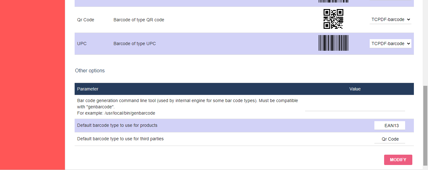

Please check Setup > modules/applications > Barcode and click on settings wheel.

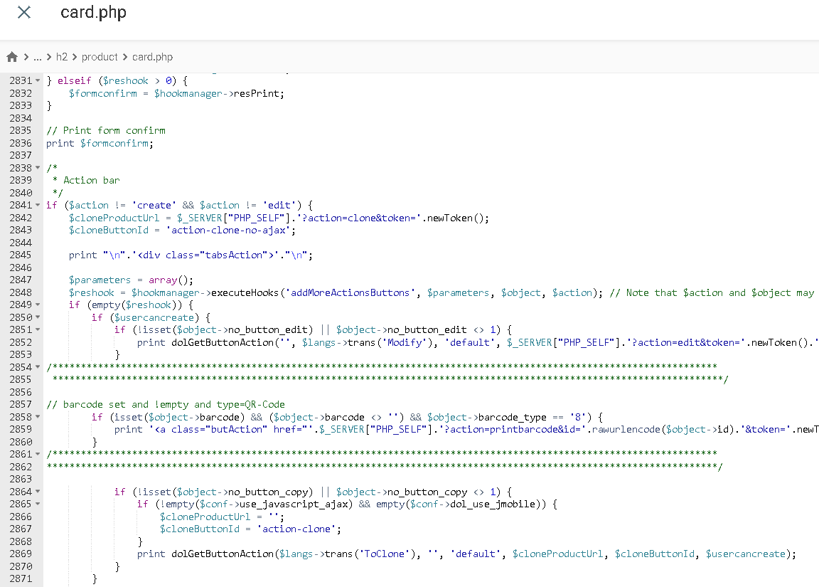

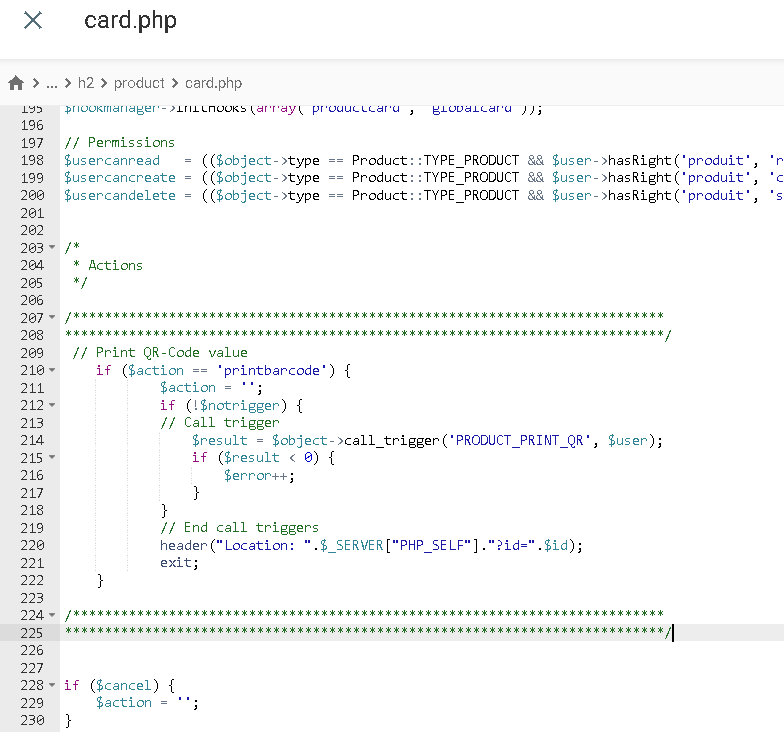

In \htdocs\product\card.php we have added a new action “printbarcode” and a button that triggers this action.
This action in turn finally triggers a URL with the print parameters.
…new action “printbarcode”:
	// Print QR-Code value
	if ($action == 'printbarcode') {
			$action = '';
			if (!$notrigger) {
			// Call trigger
				$result = $object->call_trigger('PRODUCT_PRINT_QR', $user);
				if ($result < 0) {
					$error++;
			// End call triggers
			header("Location: ".$_SERVER["PHP_SELF"]."?id=".$id);
			exit;
…new button “Print QR-Code”:
		// barcode set and !empty and type=QR-Code
		if (isset($object->barcode) && ($object->barcode <> '') && $object->barcode_type == '8') {
			print '<a class="butAction" href="'.$_SERVER["PHP_SELF"].'?action=printbarcode&id='.rawurlencode($object->id).'&token='.newToken().'">'.$langs->trans("Print QR-Code").'</a>';

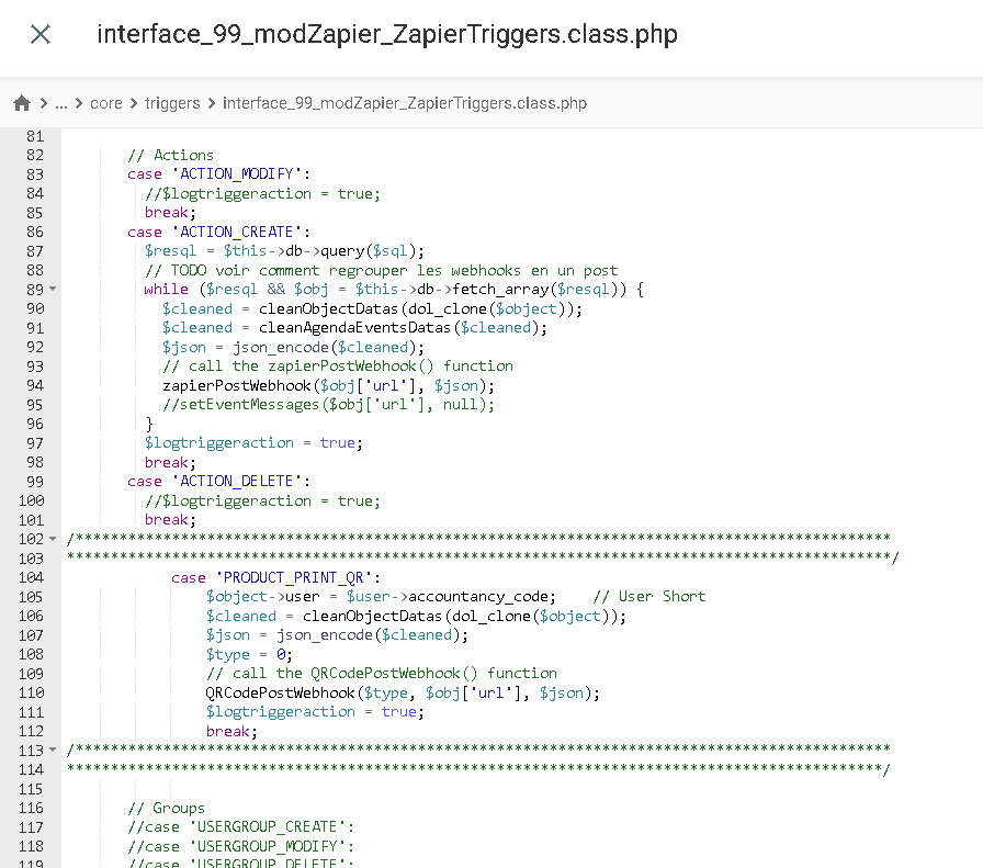

For this we copied the \htdocs\core\triggers\interface_99_modZapier_ZapierTriggers.class.php and adapted it for my needs.
As you can see, we have also added other actions for printing serial numbers from the MRP module.
		switch ($action) {
			case 'PRODUCT_PRINT_QR':
				$object->user = $user->accountancy_code;	// User Short
				$cleaned = cleanObjectDatas(dol_clone($object));
				$json = json_encode($cleaned);
				$type = 0;
				// call the QRCodePostWebhook() function
				QRCodePostWebhook($type, $obj['url'], $json);
				$logtriggeraction = true;
				break;

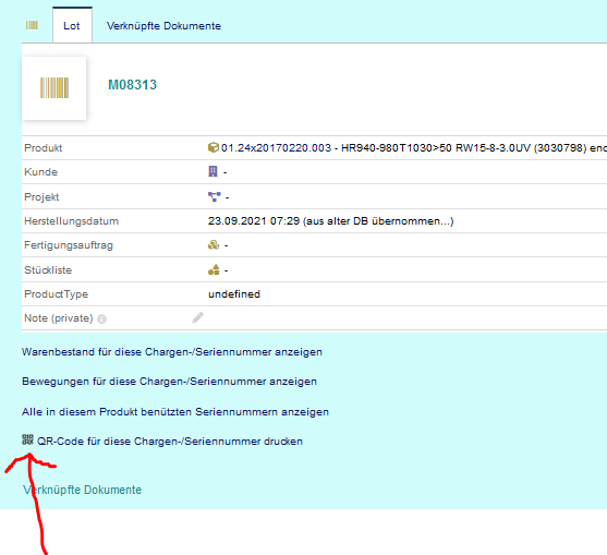

            // get lot/serial
			case 'PRODUCT_LOT_PRINT_QR':
			case 'MRP_LOT_PRINT_QR':
				$sql = 'SELECT pl.rowid, p.ref as `pref`, mp.fk_mo, mo.ref, pl.tms
					FROM '.MAIN_DB_PREFIX.'product_lot pl
					LEFT JOIN '.MAIN_DB_PREFIX.'mrp_production mp ON mp.batch = pl.batch
					LEFT JOIN '.MAIN_DB_PREFIX.'mrp_mo mo ON mo.rowid = mp.fk_mo
					LEFT JOIN '.MAIN_DB_PREFIX.'product p ON p.rowid = pl.fk_product
					WHERE pl.batch = "'.$object->barcode.'"';
				$resqlC = $this->db->query($sql);
				$result = $this->db->fetch_array($resqlC);
				$cleaned->id = $result['rowid'];
				$cleaned->name = $result['ref']." (".$result['tms'].")";
				$cleaned->ref = $result['pref'];
				$type = 2;
				break;
            // some more cases followed but not shown here...

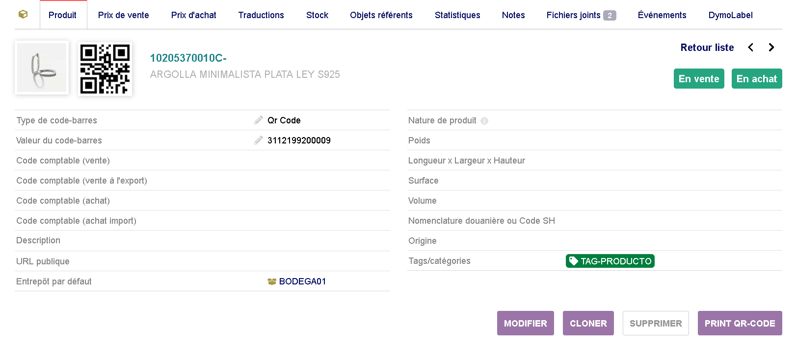

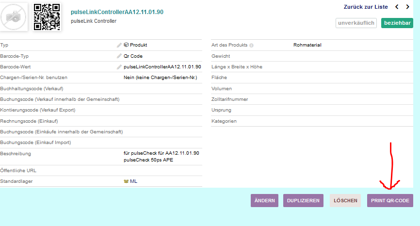

In the web interface it looks like this:

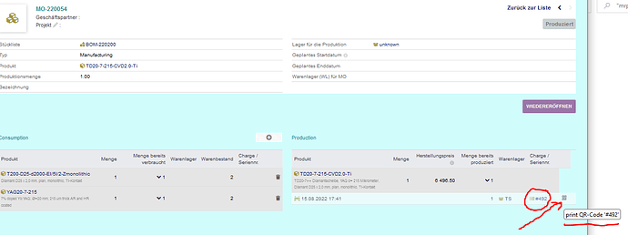

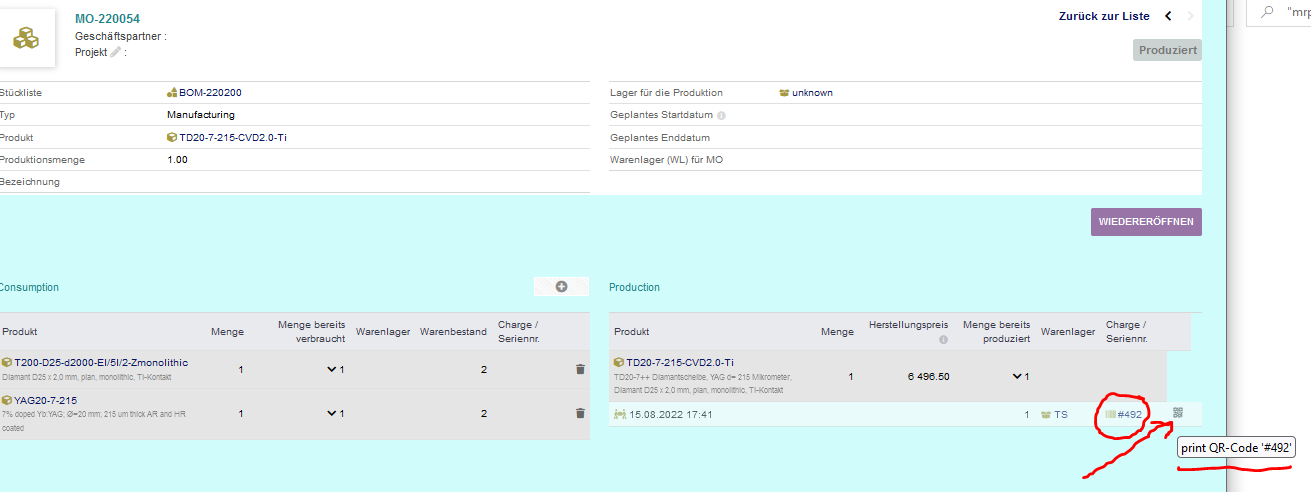

From the MRP-Module:
From the LOT-Module:

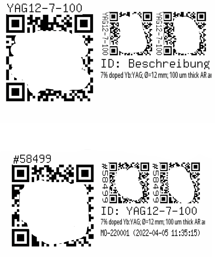

The printed label looks like this: (not the same numbers as in the examples :wink:)

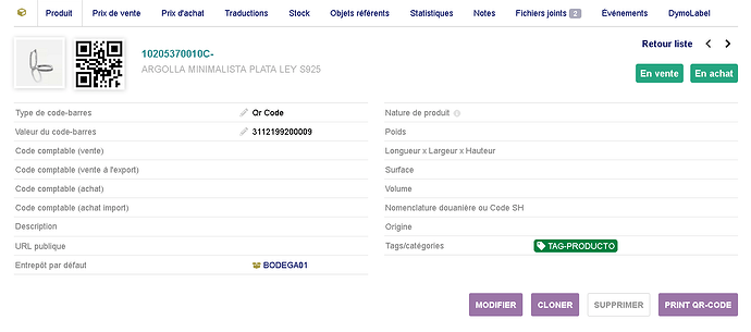

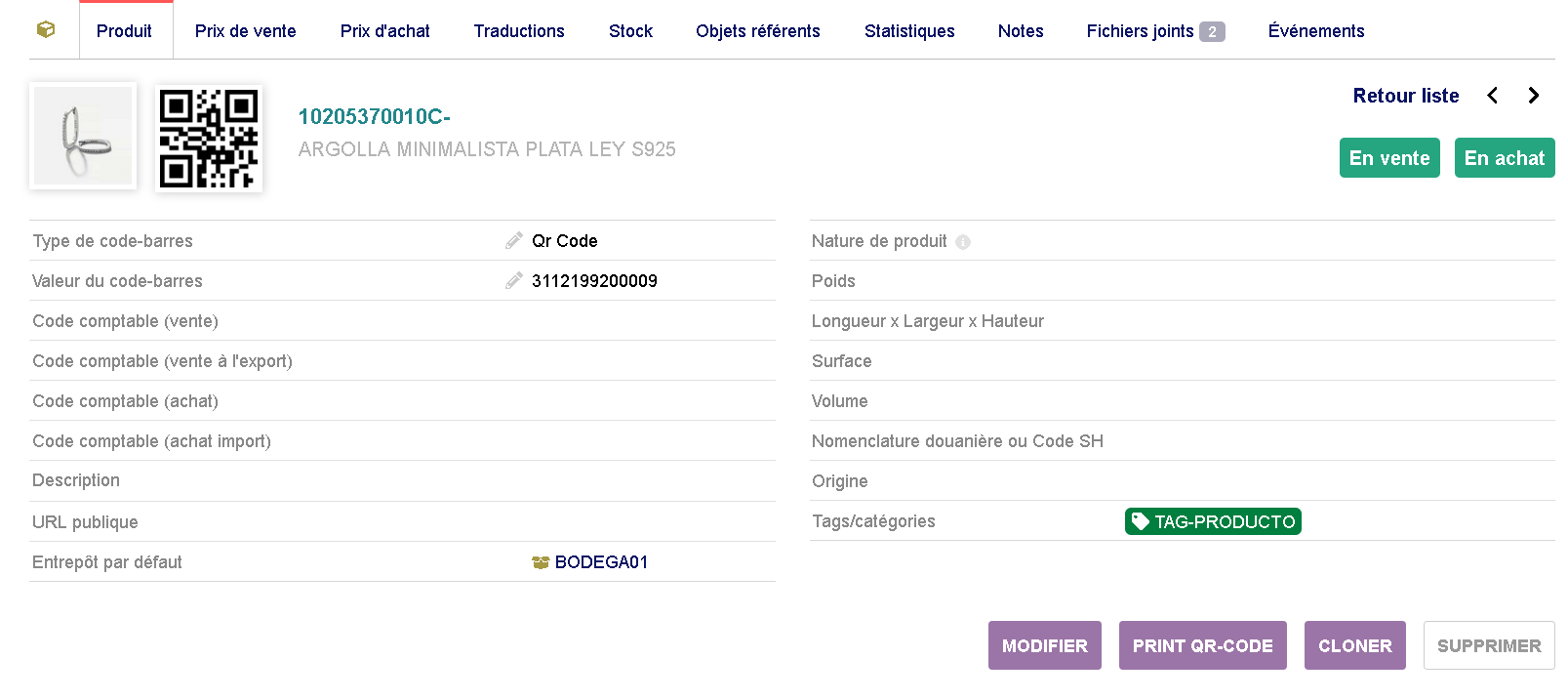

Hello Bro
I successfully make the modifications for the \product\card.php
I see the button ’ PRINT QR-CODE ’ , at the right bottom of my producto page
When I try to print, nothing happen, the url i see on the button was:
https://www.webiste.com/my_folder/product/card.php?action=printbarcode&id=35&token=1af4caeee8f87d2a4950594038f3b1f3cc

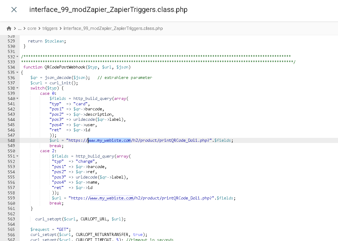

I get the file ( interface_99_modZapier_ZapierTriggers.class.php ) here :interface_99_modZapier_ZapierTriggers.class.php
I modify it andput my personal URL
$url = “://xxx.xxx.xxx.xxx/printQRCode_Doli.php?”.$fields;
but nothing

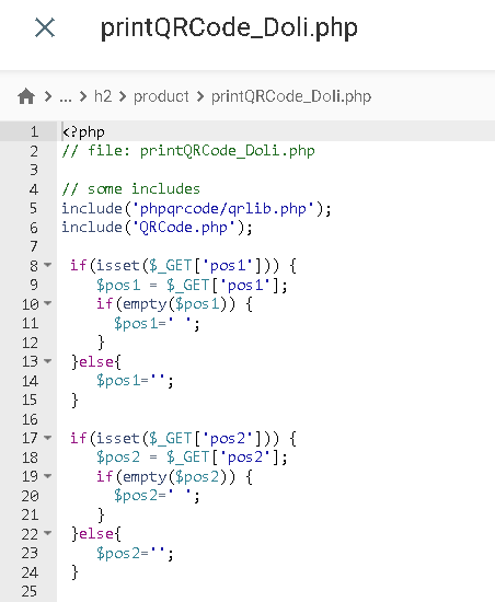

Where can i find the file printQRCode_Doli.php ?

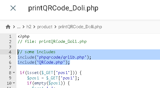

The printQRCode_Doli.php looks like the following:
You can see that we use the library “phpqrcode”
The generation and printing out the QR-Code is finally done in “QRCode.php”.
<?php
// file: printQRCode_Doli.php
// some includes
include('phpqrcode/qrlib.php');
include('QRCode.php');
 if(isset($_GET['pos1'])) {
 	$pos1 = $_GET['pos1'];
	if(empty($pos1)) {
	  $pos1=' ';
 }else{
	$pos1='';
 if(isset($_GET['pos2'])) {
 	$pos2 = $_GET['pos2'];
	if(empty($pos2)) {
	  $pos2=' ';
 }else{
	$pos2='';
 if(isset($_GET['pos3'])) {
 	$pos3 = $_GET['pos3'];
	if(empty($pos3)) {
	  $pos3=' ';
 }else{
	$pos3='';
 if(isset($_GET['pos4'])) {
 	$pos4 = $_GET['pos4'];
	if(empty($pos4)) {
	  $pos4=' ';
 }else{
	$pos4=' ';
 if(isset($_GET['typ'])) {
 	$type = $_GET['typ'];
	if(empty($type)) {
	  $type=' ';
 }else{
	$type='';
 $ret = $_GET['ret'];
file_put_contents('/tmp/qrcode.log', $pos1."|".$pos2."|".$pos3."|".$pos4."|".$type."|".$ret."\n", FILE_APPEND);
printQRCodeDolibarr($pos1,$pos2,$pos3,$pos4,$type,$ret);
exit;

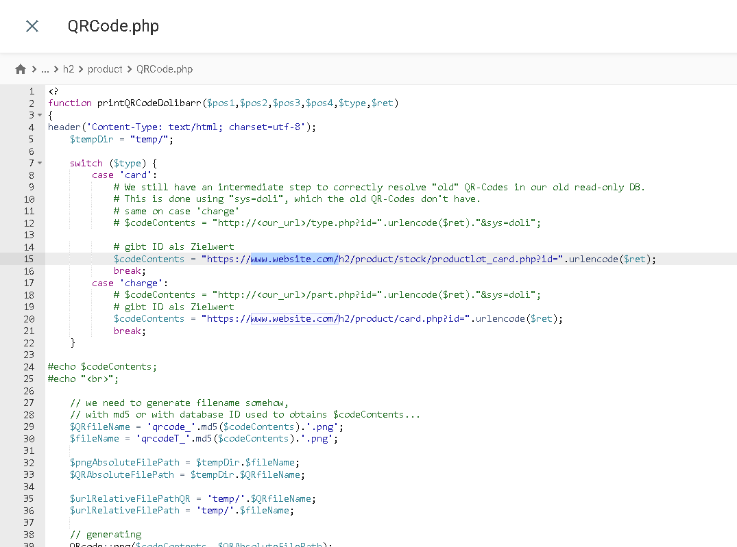

The file QRCode.php looks like:
(you can modify the $codeContents to link to other pages in Dolibarr, but we decided that these links are usefull. In case of other links you have to modify/reference the proper ID.)
BTW: You can see the resulting printed labels on my earlier post. If you use another label-printer you have to adapt to your needs.
function printQRCodeDolibarr($pos1,$pos2,$pos3,$pos4,$type,$ret)
header('Content-Type: text/html; charset=utf-8');
    $tempDir = "temp/";
	switch ($type) {
		case 'card':
			# We still have an intermediate step to correctly resolve "old" QR-Codes in our old read-only DB.
			# This is done using "sys=doli", which the old QR-Codes don't have.
			# same on case 'charge'
			# $codeContents = "http://<our_url>/type.php?id=".urlencode($ret)."&sys=doli";
			# gibt ID als Zielwert
			$codeContents = "http://<your_dolibarr_url>/product/stock/productlot_card.php?id=".urlencode($ret);
			break;
		case 'charge':
			# $codeContents = "http://<our_url>/part.php?id=".urlencode($ret)."&sys=doli";
			$codeContents = "http://<your_dolibarr_url>/product/card.php?id=".urlencode($ret);
			break;
#echo $codeContents;
#echo "<br>";
    // we need to generate filename somehow,
    // with md5 or with database ID used to obtains $codeContents...
    $QRfileName = 'qrcode_'.md5($codeContents).'.png';
	$fileName = 'qrcodeT_'.md5($codeContents).'.png';
    $pngAbsoluteFilePath = $tempDir.$fileName;
	$QRAbsoluteFilePath = $tempDir.$QRfileName;
    $urlRelativeFilePathQR = 'temp/'.$QRfileName;
	$urlRelativeFilePath = 'temp/'.$fileName;
    // generating
    QRcode::png($codeContents, $QRAbsoluteFilePath);
    echo 'Server PNG File: '.$pngAbsoluteFilePath;
    echo '<hr />';
    // displaying
    echo '<img src="'.$urlRelativeFilePathQR.'" />';
	$im = imagecreatefrompng($QRAbsoluteFilePath);
	//imagesavealpha($im, true); // important to keep the png's transparency
	if(!$im) {
		die("im is null");
	$black = imagecolorallocate($im, 0, 0, 0);
	list($width, $height) = getimagesize($QRAbsoluteFilePath);
	$QL700width = 756;
	$largeQRpercentage = 0.5;
	$smallQRpercentage = 0.25;
	$heightLargerPercentage = 1.1;
	$newheight = $heightLargerPercentage*$height*$QL700width/$width*$largeQRpercentage ; // the height of the image
	$font = 6; // font size
	$leftTextPos = 10; // left position text
	$newImage = imagecreate($QL700width,$newheight);
	$QLImage = imagecreatetruecolor($QL700width,$newheight);
	imagecopyresampled($newImage,$im,0,10,0,0,$QL700width,$newheight/$heightLargerPercentage,$width/$largeQRpercentage,$height);
	imagecopyresampled($newImage,$im,$largeQRpercentage*$QL700width,20,0,0,$QL700width,$newheight/$heightLargerPercentage,$width/$smallQRpercentage,$height*$largeQRpercentage/$smallQRpercentage);
	imagecopyresampled($newImage,$im,($largeQRpercentage + $smallQRpercentage)*$QL700width,20,0,0,$QL700width,$newheight/$heightLargerPercentage,$width/$smallQRpercentage,$height*$largeQRpercentage/$smallQRpercentage);
    $label = $pos1;
    $labelfont = 4;
	$labelfont_large = 4;
	// pixel-width of label
	$txtsz = imagefontwidth($labelfont) * strlen($label);
	$txtsz_large = imagefontwidth($labelfont_large) * strlen($label);
	// pixel-height of label
	$txtht = imagefontheight($labelfont);
	$txtht_large = imagefontheight($labelfont_large);
	$labelimage = imagecreate($txtsz,$txtht);
	$labelimage_large = imagecreate($txtsz_large,$txtht_large);
	$white = imagecolorallocate($labelimage, 0xFF, 0xFF, 0xFF);
	$black = imagecolorallocate($labelimage, 0x00, 0x00, 0x00);
	$white = imagecolorallocate($labelimage_large, 0xFF, 0xFF, 0xFF);
	$black = imagecolorallocate($labelimage_large, 0x00, 0x00, 0x00);
	imagestring($labelimage, $labelfont_large, 0, 0, $label , $black);
	imagecopyresampled($newImage,$labelimage,40,0,0,0,3*$txtsz_large, 3*$txtht_large,$txtsz_large, $txtht_large);
	imagestring($labelimage, $labelfont, 0, 0, $label , $black);
	$labelimage1 = imagerotate($labelimage, -90, $white);
	imagecopyresampled($newImage,$labelimage1,$largeQRpercentage*$QL700width-10,40,0,0,2*$txtht, 0.8*$smallQRpercentage*$QL700width,$txtht, $txtsz);
	imagecopyresampled($newImage,$labelimage1,($largeQRpercentage + $smallQRpercentage)*$QL700width-10,40,0,0,2*$txtht, 0.8*$smallQRpercentage*$QL700width,$txtht, $txtsz);
    $label = "ID: ".$pos2;
	$labelinfo = imagecreate($txtsz,$txtht);
	$white = imagecolorallocate($labelinfo, 0xFF, 0xFF, 0xFF);
	$black = imagecolorallocate($labelinfo, 0x00, 0x00, 0x00);
	imagestring($labelinfo, $labelfont, 0, 0, $label, $black);
	imagecopyresampled($newImage,$labelinfo,$largeQRpercentage*$QL700width-10,$smallQRpercentage*$QL700width+5,0,0,3*$txtsz, 3*$txtht,$txtsz, $txtht);
    $label = $pos3;
    $labelfont = 7;
	$labelfont_large = 6;
	// imagestring($labelinfo, $labelfont, 0, 0, $label, $black);
    // changed to TrueType-Font for correct display of german umlauts
	$font = '/usr/share/fonts/truetype/droid/DroidSans.ttf';
	imagettftext($labelinfo, $labelfont, 0, 0, 10, $black, $font, $label);
	imagecopyresampled($newImage,$labelinfo,$largeQRpercentage*$QL700width-10,$smallQRpercentage*$QL700width+50,0,0,2*$txtsz, 3*$txtht,$txtsz, $txtht);
    $label = $pos4;
   	$labelfont = 2;
	$labelfont_large = 2;
	imagecopyresampled($newImage,$labelinfo,$largeQRpercentage*$QL700width-10,$smallQRpercentage*$QL700width+90,0,0,2*$txtsz, 3*$txtht,$txtsz, $txtht);
	imagepng($newImage, $pngAbsoluteFilePath, 0);
	imagedestroy($im);
	imagedestroy($labelimage1);
	imagedestroy($labelinfo);
	imagedestroy($labelimage);
	echo '<img src="'.$urlRelativeFilePath.'" />';
	// printing to QL-700
	shell_exec("lp -d QL-700 -o orientation-requested=6 ".$pngAbsoluteFilePath);

Hello DG-Rilling
I make all the necessary, but always some interogations from my part
Sorry
I resume:
File: htdocs/…/product/card.php
and
File: htdocs/…/core/triggers/interface_99_modZapier_ZapierTriggers.class.php
and
I change the name of my website of course
Then, I created the files here:
htdocs/…/product/printQRCode_Doli.php
htdocs/…/product/QRCode.php
It’s happen nothing
1°) Could you tell me where did you put your printQRCode_Doli.php and QRCode.php ?
2°) Where can i have this qrlib.php ?
Sorry for the disturb…
The description is based on our configuration with <Dolibarr (Cloud) <–INTERNET–> WebServer with LabelPrinter (Local)>
Therefore are both files
“printQRCode_Doli.php” and “QRCode.php” located on the local-pc where the labelprinter is connected. Printing is finally done with the "shell_exec(“lp -d QL-700 …”)
If you are running Dolibarr on a local machine with labelprinter directly connected then you don’t need the “printQRcode_Doli.php”
because in the function QRcodePostWebHook(…) you have all the variables for the label.
And Dolibarr has the functionality to produce the QR-Code, look at htdocs\includes\tecnickcom\tcpdfhtdocs/include
There you will find the library and also some examples.
