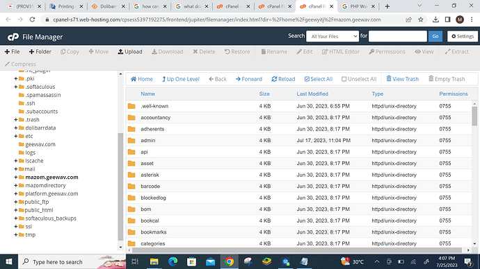

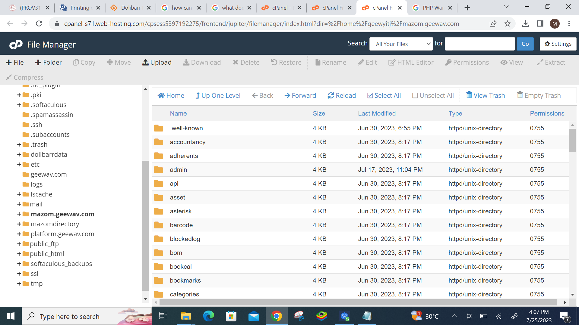

Should the “.well known” folder be in the list?
Thank you
Hi @Absmachin,
you need to download only one file. Both contain the same data but with a different tool compressed. If you upload the files via ftp and if you are using Windows on your own computer, I think you can go with the zip file as you can open it easily with Windows.
Open the downloaded zip file, find the mentioned file, and upload it to the location I mentioned before. Then the error you wrote should be solved.
Regarding the .well-known folder: As I know this is not a standard folder of Dolibarr. I can see in your screenshot there is a folder softaculous and I guess you used the software of your hoster to install Dolibarr which uses softaculous. Therefore my assumption would be that the folder comes from the automatic installation.
Regarding the other error with the products not showing up in the list: I am not sure if this will solve it. My recommendation is: First solve the issue you mentioned before with the missing file. Then go to the next error and check if it is now working. If not, then again check the logs.
