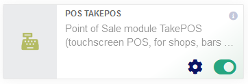

If you want to use POS printer, you need to use TakePOS module :raised_back_of_hand:

Thank you, i have tried it, however, not thekind of solution that we are looking for
I thought we could print our the regular invoice created through the POS module to be able to fit into the thermal paper size printer we have.
Besides we dont have the POS terminal for this
any other help from your side?

→ that is normaly for tickets, not invoices, please have a look at TakePOS …

Would look at the TakePOS option.
