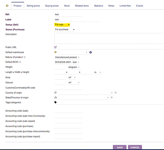

I am not sure how TakePos filters for products, but the customer invoice should show only products which are marked as sellable. In the product the field “Status (sell)” needs to be set to “For sale”. Maybe this helps:
Regards,
Sven

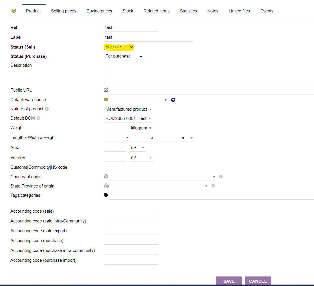

@sp_digitalcentric.de
I have set this on sell and purchase, this thing just started this morning…
Let me check maybe by error it was changed
Thank you
Its on for Sale and Purchase
I dont know where next to check

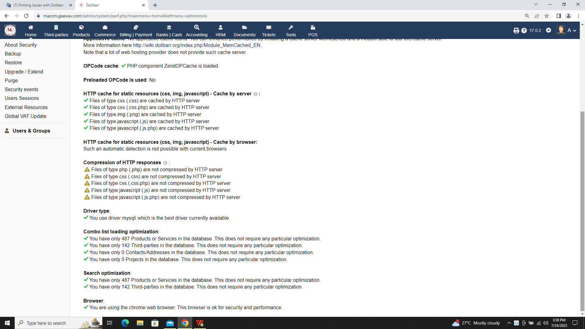

@rycks Ooops!
Could this be the cause, even though i am yet to trace how to correct it if it is
Thank you
