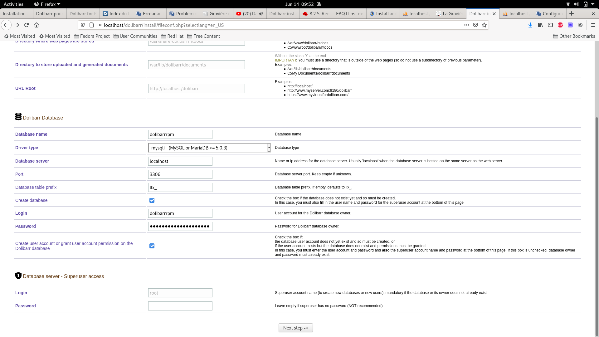

Hello I’m going through on a local installation of dolibarr and I have some troubles with step 1. They ask me my SuperUser Username and Password. Username is not changeable and it is root. So I put in my root password (the one I use when using mysql on command line or logging in PhpMyAdmin, it is the same password) and they display me this error :
Access denied for user ‘root’@‘localhost’ (using password: NO)
The database connection failed: the host or super user parameters must be wrong.
Go back and check/correct the parameters.
And I don’t see what could bring up this error. Is it possible to get some help on this issue ?

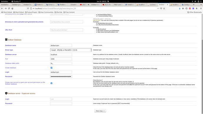

Hello Yesbee ! I’ve created the database and the user but the superuser is still a problem, I can’t chance the superuser ID It’s stuck on root and I can’t go on.
The problem is the superuser credentials at the bottom and not the actual user on the database
Please remove check mark from create database and the check mark from create user account or grant user account on the dolibarr database since you hv already created the database and user manually.
That should solve the problem. If yes, please check the “solution” so that it would be useful to others as well.
thanks !
